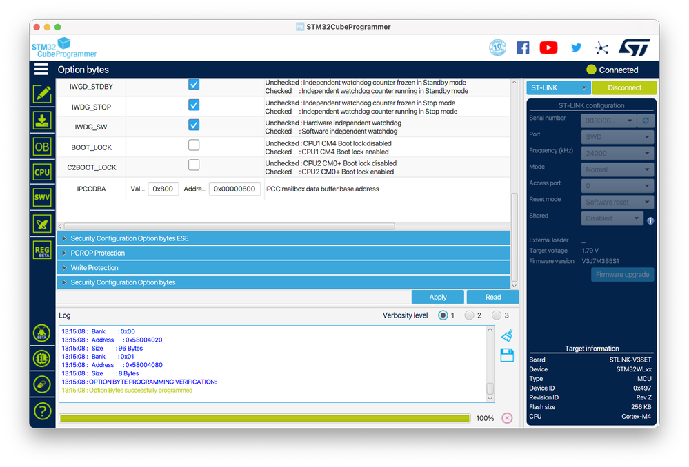

WL55CC: OB IPCCDBA/pMb_RefTable mismatch even after stlink programming
bblouin

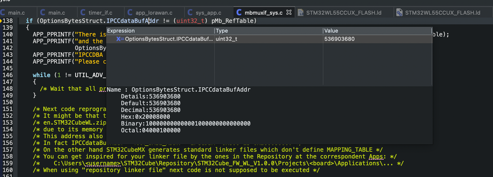

Programmed OB IPCCDBA to 0x8000693W00000BdTS1QAN.pngValue of OB struct.ipcc data buffer:
Details:536903680
Default:536903680
Decimal:536903680
Hex:0x20008000
Binary:100000000000001000000000000000
Octal:04000100000

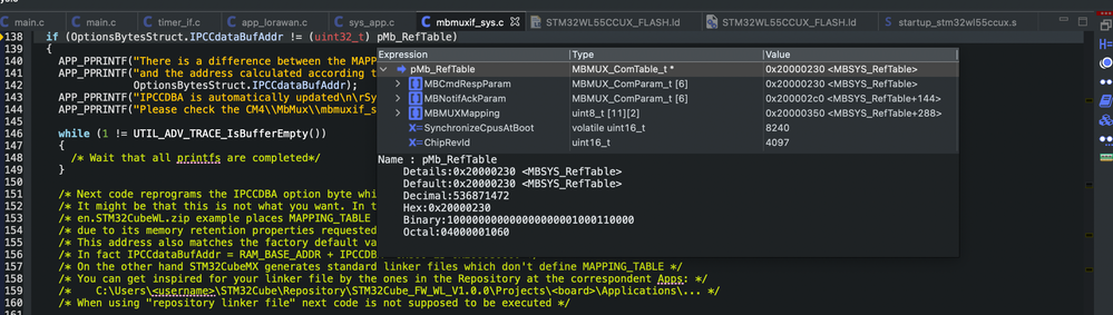

Value of pMb_RefTable:
Details:0x200000e4 <MBSYS_RefTable>
Default:0x200000e4 <MBSYS_RefTable>
Decimal:536871140
Hex:0x200000e4
Binary:100000000000000000000011100100
Octal:04000000344
Values flashing OB IPCC to 0xe4
Details:536874560
Default:536874560
Decimal:536874560
Hex:0x20000e40
Binary:100000000000000000111001000000
Octal:04000007100
Decimal:536871140
Hex:0x200000e4
Octal:04000000344
How do I correct this shift? I've tried many ways and it still doesn't work.
bblouin
CM4 linker didn't have ref to shared region
7 REPLIES 7
YBOUV.1
can you please describe your Setup e.g HW(Board and WL chip) /FW/IDE
it seems that the MBSYS_RefTable is not placed properly. It must be at 0x20008000.
If you have generated your project from scratch from cubeMx, the scatter file (.ld) may not be the correct one.
Can you check your .ld file and compare it with
https://github.com/STMicroelectronics/STM32CubeWL/blob/main/Projects/NUCLEO-WL55JC/Applications/LoRaWAN/LoRaWAN_End_Node_DualCore/STM32CubeIDE/CM4/STM32WL55JCIX_FLASH.ld
Also please check the M0+ side,
For you information, Cube1.1.0 will be available within few days and will have some improvement regarding the OB loading (done in the FW automatically)
