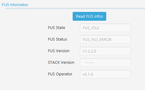

Reading the FUS information under section "Firmware Upgrade Service" gives the following result:
(I also have a custom board with a STM32WB5MMG where I deleted the previously loaded wireless stack. The STACK version display shows "v0.0.0.0".)

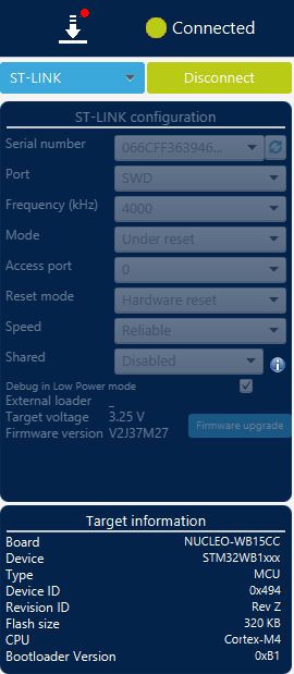

Just in case this could be a potential problem, here is information on my setup:

Update
After deleting the wireless stack once again on the Nucleo-WB15, the shown STACK-version remains "------", but now SRAM2a is unsecured. Although having access to SRAM2b would be nice, I think the combined size of SRAM1 (12KB) and SRAM2a (32KB) will be sufficient.
