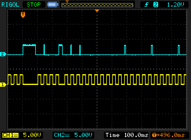

We are using an STM32WB55CG and trying to send 207 bytes of data every 40ms. I can see that data length extension has been enabled and the packets are not fragmented. We are getting the error returned BLE_STATUS_INSUFFICIENT_RESOURCES on average about once a second.
Is there anything that can be done to increase the amount of resources available?
Any tips on what I can do to eliminate this error?
Thanks!

‎2019-12-03 7:27 AM
​Extract from AN5270 p 101:
ACI_GATT_UPDATE_CHAR_VALUE
Description
Update a characteristic value in a service. If notifications (or indications) are enabled on that characteristic, a
notification (or indication) is sent to the client after sending this command to the STM32WB. The command is
queued into the STM32WB command queue. If the buffer is full, because previous commands could not be still
processed, the function returns BLE_STATUS_INSUFFICIENT_RESOURCES. This happens if notifications (or
indications) are enabled and the application calls ACI_GATT_UPDATE_CHAR_VALUE at an higher rate than
what is allowed by the link. Throughput on BLE link depends on connection interval and connection length
parameters (decided by the master, see aci_l2cap_connection_parameter_update_request() for more info on how
to suggest new connection parameters from a slave). If the application does not want to lose notifications
because STM32WB buffer becomes full, it has to retry again till the function returns BLE_STATUS_SUCCESS or
any other error code.
So this means that the link is not fast enough. One way to avoid this overfow would be to increase the size of the queue.

‎2019-12-03 8:19 AM
In fact it is not easy to increase the command queue. The best is to manage the events notifying the availability of the buffers.
Roughly you have to stop any transfer until you get the EVT_BLUE_GATT_TX_POOL_AVAILABLE (EVT_VENDOR) event.
Have a look at the BLE_DataThroughput project here:
C:\STM32Cube_FW_WB_VX.Y.Z\STM32Cube_FW_WB_V1.3.0\Projects\P-NUCLEO-WB55.Nucleo\Applications\BLE\BLE_DataThroughput
This is an example of data throuput management.
‎2019-12-03 11:31 AM
In this screen shot, trace 2 (the blue trace) goes high whenever we get the BLE_STATUS_INSUFFICIENT_RESOURCES error. Trace 2 goes low whenever we get EVT_BLUE_GATT_TX_POOL_AVAILABLE so that we may resume BLE transmission. Trace 1 (the yellow trace) changes state after each successful transmission.
As you can see we are running out of resources quite often and, occasionally, for extended (close to 100 ms) periods of time.
Are we overrunning the command queue this often?
Would adjusting our link interval timing possibly help this?
Is there anything beyond slowing down our transmission rate that could help here?
This project was based on the Data Throughput example but with the hope of not having to throttle the transmission.
Thanks.
