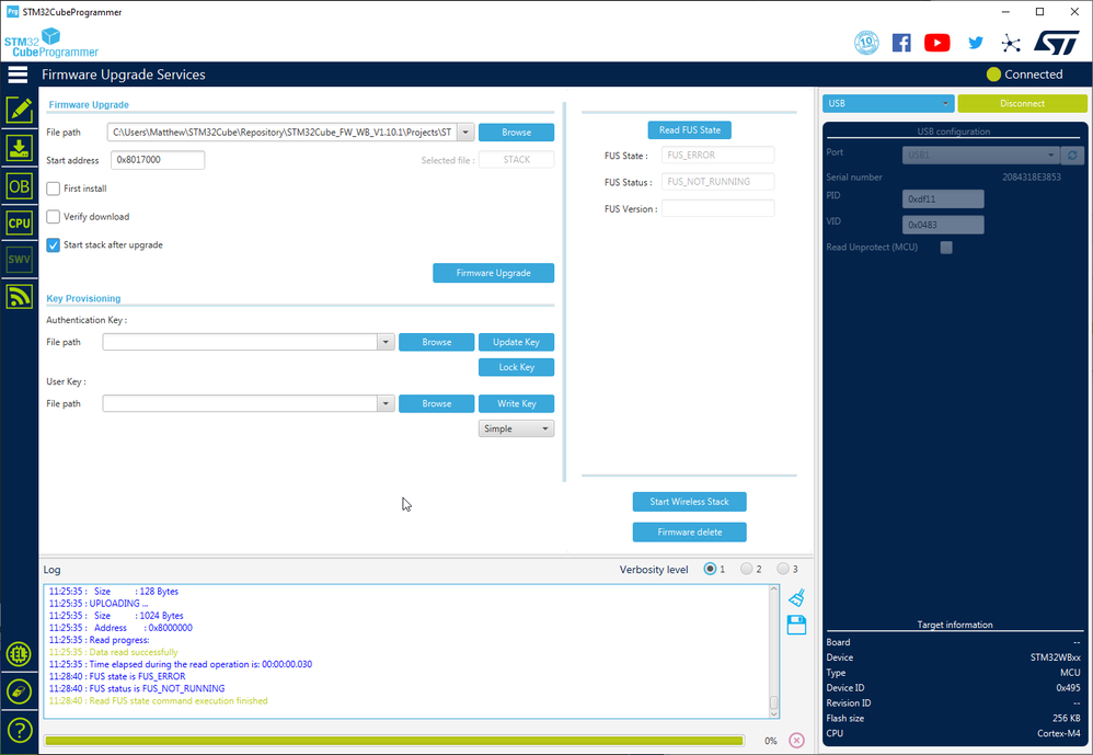

I followed UM2550 section 5: when I get to "Download new wireless stack" I get the following error:
0693W000007E2flQAC.pngThe Copro Binaries do not list this 256K chip in the binary tables; I'm assuming the FUS address is 0x0803A00, and BLE_Stack_full_fw 0x800B000, it's possible I'm not using the correct address for the BLE stack.

​OK. You have the most recent FUS version. This is good. Now you need to program the M0+ FW (RF stack).
The error is resulting from the fact that you try to start the wireless stack though it is not installed.
Select the BLE stack =  stm32wb3x_BLE_Stack_full_fw.bin file here under this directory: STM32Cube_FW_WB_V1.10.0\Projects\STM32WB_Copro_Wireless_Binaries\STM32WB3x.
Once it is programmed, the SFSA value should be different from 0xF4.
Then select one application among those proposed: BLE_p2pserver for example and download it at address 0x08000000.
When the application is programmed, you can remove the connector CN5-CN7 and reset the board.
A small LED should be blinking.
You can use the BLE sensor Android application on your mobile to detect your board and connect to it.

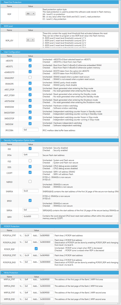

Now could you show me the option bytes?
MAlbr.1

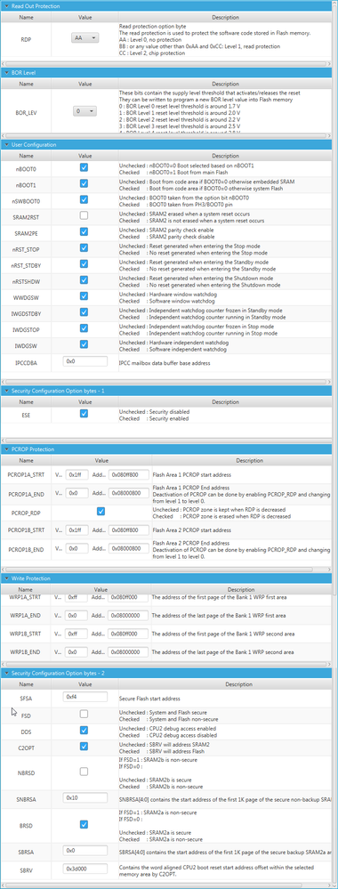

I have a new chip that has never been programed, here is what I see from DFU and from ST-LINK.

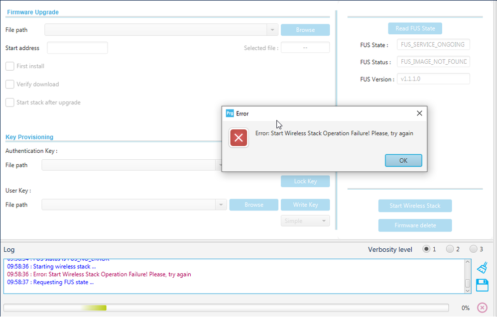

When I click Start Wireless Stack in DFU from STM32CubeProgrammer it throws an error and the entire application crashes.0693W000008GKKyQAO.png

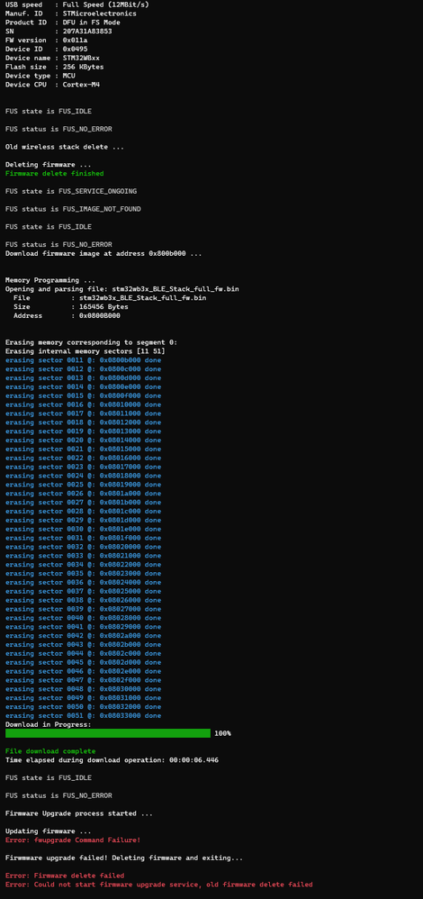

These are the settings I used to update on my new chip:
0693W000008GL7HQAW.pngI get a Warning after flashing: "Warning: Connection to device 0x495 is lost", I attached the log.

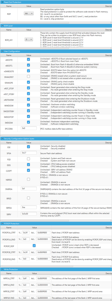

After reconnecting to the DFU device this is what I see for my option bytes:
I then downloaded "STM32Cube_FW_WB_V1.10.1\Projects\P-NUCLEO-WB55.USBDongle\Applications\BLE\BLE_p2pServer\Binary\BLE_p2pServer_reference.hex" to the device at 0x08000000 and removed my BOOT0 jumper. When I start the device I see my green and blue LED (PB0, PB1) turn on, after another hardware reset I can see a device called "P2PSRV1" in the ST BLE Sensor app.

​Seeing the P2PSRV1 name in the ST BLE sensor application shows your board was properly programmed and is working fine.
Now the issue is in your application. No name may mean you did not use /create a name in your application.
Look ath the app_ble.c file under STM32Cube_FW_WB_V1.10.0\Projects\P-NUCLEO-WB55.Nucleo\Applications\BLE\BLE_p2pServer\STM32_WPAN\App.  This file contains the definition of the local_name variable which is then used in the aci_gap_set_discoverable function to start the advertizing phase.
Do you see a device with no name but a mac address appearing on your mobile screen when you turn the board on?
What kind of application are you trying to build?
You should mimic what is done in the BLE_p2pserver application especially the release of the CPU2 to boot on the RF FW.
>This BLE_p2pServer does not appear to open in STM32CubeIDE
Go to STM32Cube_FW_WB_V1.10.0\Projects\P-NUCLEO-WB55.Nucleo\Applications\BLE\BLE_p2pServer\STM32CubeIDE and click on .cproject icon. The project should open in CubeIDE.
