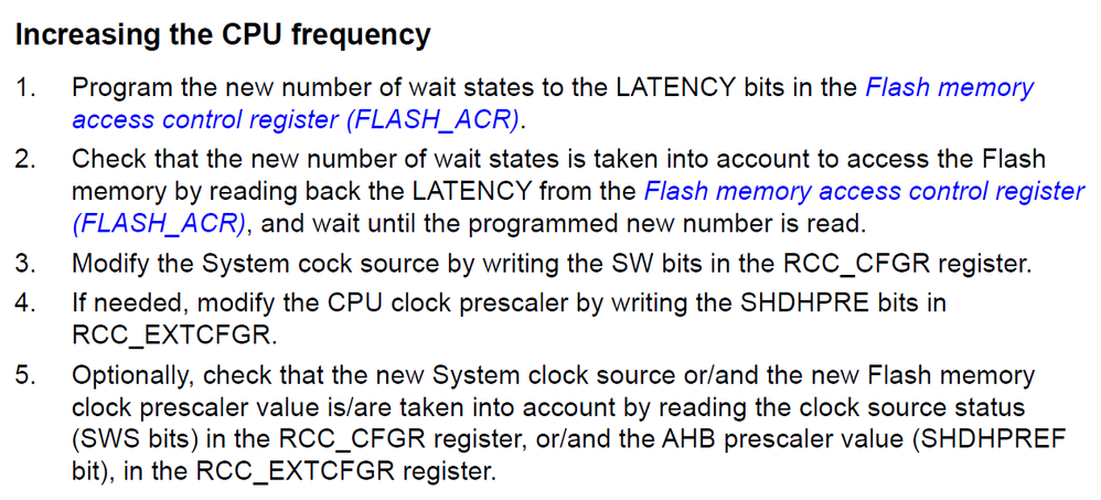

Im running into some issues with trying to set the clock speed of my stm32wb55 chip above 32MHz on my custom board.
Here is my baremetal startup code that works using MSI as sysclk

However if I change line 20 to this:
// RCC_MSI_CLOCK_SPEED_48MHz = 0xB
RCC->CR |=  RCC_MSI_CLOCK_SPEED_48MHz << RCC_CR_MSIRANGE_Pos;
My program will refuse to run. Trying to step through with gdb after this line will result in a SIGTRAP.
I get the same results if I configure the PLL clock to anything greater than 32MHz and use that as my sysclk.
Any thoughts on this? Could it be an unstable power supply on my custom board?

Did you follow the RM notes on increasing CPU frequency? Namely wait states.
Are you following the guidelines for modifying MSIRANGE? Modifying the register in a single operation rather than twice in a row is a better idea.

Can't see what's in rcc_reset from here.

rcc_reset() sets all the rcc registers to their default values specified in the reference manual.
I should be following the guidelines stated there. MSI is ready at that point.
Its just strange that I can increase the clock from 4MHz on reset to anything besides values over 32MHz.
But are you? Where do you modify wait states?
> RCC->CR &= ~(RCC_CR_MSIRANGE);
> RCC->CR |= RCC_MSI_CLOCK_SPEED_32MHz << RCC_CR_MSIRANGE_Pos;
How do you know MSI is ready between those two statements? You certainly aren't checking in the code.

I added in the MSI ready check and set the wait state to 2 and the firmware runs perfectly fine now
