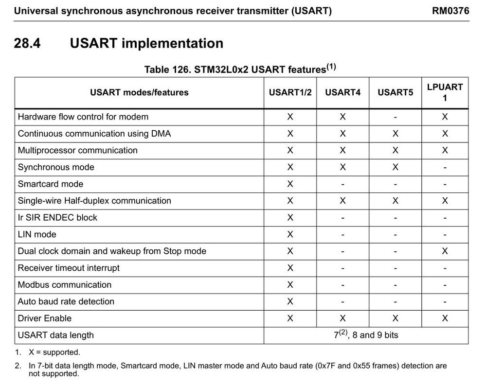

Hi, I am modifying the sample program End_Node on the kit B-L072Z-LRWAN1.
UART2 is configured as a virtual com and works correctly on PA2 and PA3 pins. I'm trying to add a second serial on PA9 and PA10 but I can not receive and transmit anything. I then tried to modify the working virtual com to use the PA9 and PA10 pins but without success.

2019-03-01 8:04 AM
If it is using DMA, those settings are probably wrong.
Make sure there aren't any secondary references to USART2
2019-03-01 8:23 AM
Hello, thank you for your answer!
I checked there are no other references to UART2 in the project.
It's like there's some Clock / DMA / Interrupt setting that works on UART2 that can not be applied to UART1 even if the data sheet would not look like:
