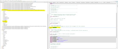

‎2024-09-08 11:48 PM
Ok I have added all the screenshots step by step
1. I-NUCLEO-LRWAN1 file.
2. Project Workspace-> main.c file, in the while loop I am calling Lora_SendData() function with the parameter as structure data containing buffer and the port.
3. This function calls Modem_AT_Cmd() function that takes structure and AT command as the parameter value.
4. This calls AT_Cmd_format() function which makes the AT string and stores it in the AT command buffer.
5. The Modem_AT_Cmd() function calls at_cmd_send() function which again calls HAL_UART_Transmit() which finally transmit the data stored in the huart2 TDR register.
I have attached the screenshot sequentially in the order functions have been called.
