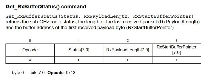

  2. Implementation of command Get_RxBufferStatus() (0x13) seems to be different than showed in manual. In the example code (and in the working device) I can't receive status byte showed in the manual. Is it bug/manual mistake or am I missing something?
void SUBGRF_GetRxBufferStatus( uint8_t *payloadLength, uint8_t *rxStartBufferPointer )
    uint8_t status[2];
	if(SUBGRF_ReadCommand( RADIO_GET_RXBUFFERSTATUS, status, 2 ) == HAL_OK)
    // In case of LORA fixed header, the payloadLength is obtained by reading
    // the register REG_LR_PAYLOADLENGTH
    if( ( SUBGRF_GetPacketType( ) == PACKET_TYPE_LORA ) && ( LoRaHeaderType == LORA_PACKET_FIXED_LENGTH ) )
        *payloadLength = SUBGRF_ReadRegister( REG_LR_PAYLOADLENGTH );
    else
        *payloadLength = status[0];
    *rxStartBufferPointer = status[1];
