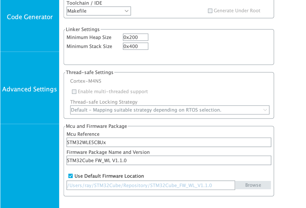

Hi @IREMI.1​ ,
I don't see the "Advanced Settings -> generate Func Calls" option in CubeMX 6.4.0. Was it removed? Please see the attached picture.
I am having the same issue, so I manually workaround it by making MX_SUBGHZ_Init() non-static, and not calling it in main(). Is it the right approach for now?
Sorry. I see the option now.
