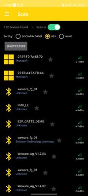

Does that phone discover other things advertising?
Not just this phone, tried it with 4 other android phones and these werent able to discover

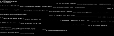

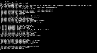

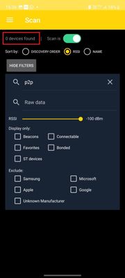

Yes, the phone is able to discover other things advertising. please find the attached screenshot for your reference as follows:
1> Serial logs of the STM32WBA55 nucleo :
2> Screen shot of ST tool box on phone without any filter:
3> Screen shot of ST tool box on phone with "p2p" filter

To make your serial log easier to read, reconfigure the terminal to do a Carriage-Return when it receives a Newline.
