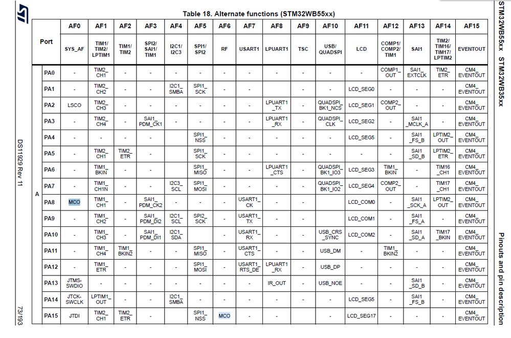

According to the Datasheet, MCO on the dual core WB chips is available as an "SYS_AF" and an "RF" alternate function. Does this has an impact if I want to use them from the main core?
