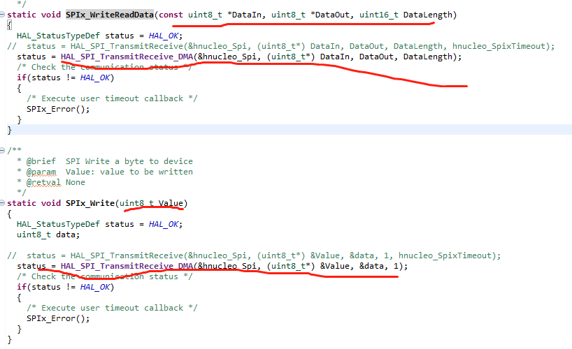

Thanks again:beaming_face_with_smiling_eyes: . The data comes from ads1299. I use the spi driver (spi mode, no dma) of adafruit shield in the example of stm32wb55. After I add dma, it does not work (spi is ok). It should be a problem with my dma configuration. Is there any example that can make it Shall I take a look?
dma configuration

write data function 0693W00000WKmOYQA1.png(about fatfs driver)

in spix_write : data is not set ! should be "1" , not pointer. right ?
Thanks again. I just use SPIx_ReadWriteData() in my sd driver.:face_with_tears_of_joy:
