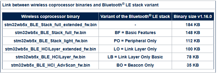

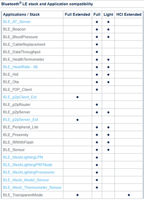

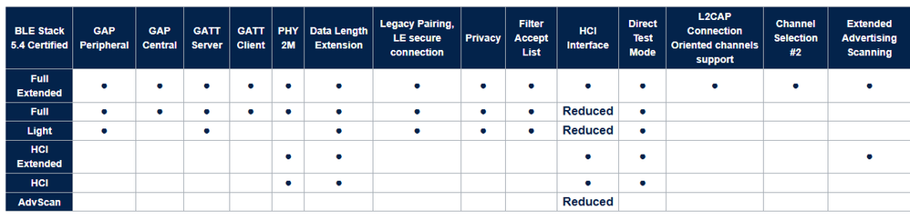

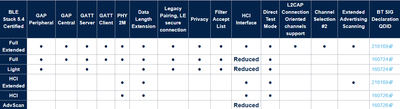

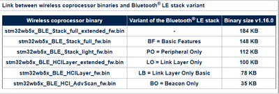

Sudarshan0000
Hello @dxxx0001,
   Refer Below images which I found in STMicroelectronics Official Documents as per this tables you will able to identify which BLE stack required.
Thank you.
