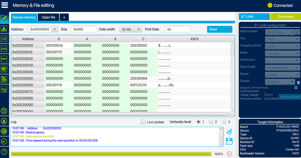

Hi.
I have nucleo board with STM32WB55RGV6 mcu. Trying to start FUS using StCubeProgrammer (swd mode), and unable to start it and even get its version. I do what is described in wiki: connect in normal mode + hardware reset, start fus, disconnect, start in hotplug mode. Tryed many combination but nothing works. What can be the reason?Screenshot 2023-09-20 at 10.57.30.png
                        STM32CubeProgrammer v2.14.0
ST-LINK SN  : 066FFF545057717867055039
ST-LINK FW  : V2J43M28
Board       : P-NUCLEO-WB55
Voltage     : 3.21V
SWD freq    : 4000 KHz
Connect mode: Normal
Reset mode  : Software reset
Device ID   : 0x495
Revision ID : Rev B
Device name : STM32WB5x/35xx
Flash size  : 1 MBytes
Device type : MCU
Device CPU  : Cortex-M4
BL Version  : 0xD2
Debug in Low Power mode enabled

4 REPLIES 4

gprgprgpr
All those tutorials show "happy path" when everything works, I wouldn't have asked the question in that case. I tried all combination with dfu, uart, and I suspect bootloader might be damaged somehow, I can connect to board only using st-link.
This board is from ebay and I suspect it might be damaged. Just wanted to ensure I'm not missing something obvious before returning it.
detakm
From what I can see your device's ESE, FSD, NBRSD and BRSD option bytes look incorrect. I am not certain how your device ended up in that situation but a common cause (from what I've learned) is disrupting power to the device when FUS is working with flash or writing option bytes.
