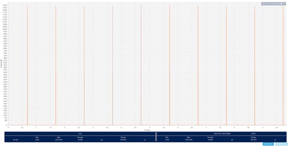

I'm attaching the Beacon example with stop mode enabled.
Please let me know if it works on your side, you can see the current consumption of this application below.
Also, before measurement please remove JP2 and everything from JP5.

Thak you @FilipKremen.
I understand what the example code you provided does. But that's not what I want to do.
I want the microcontroller to go to sleep for a certain amount of time (a few dozen minutes) after performing certain operations (acquisition of quantities, updating the EddystoneTLM_InitStruct structure for transmission with the Eddystone TLM protocol). To put the microcontroller to sleep, I use the following sequence:

Everything works correctly: data transmission, the microcontroller in sleep, and waking up.
The problem is that even when the microcontroller is in sleep, I can still detect some transmission activity from my device using the sniffer (I haven't been able to identify what type of transmission it is).
This is a big problem because I'm consuming power (due to this activity) even when the microcontroller is asleep. Apparently, part of the firmware (stack) residing on CPU2 continues to send BLE packets. How can I stop this activity?
FilipKremen
stop mode 2 is the deepest mode when RF can be still active. For your case, the standby mode could be more suitable. As I mentioned before, it's not necessary to do anything about entering low power mode, the sequencer will automatically enter the chosen low power mode. Please read this document for more information.
