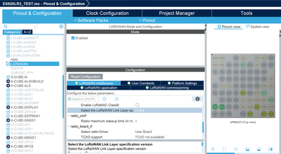

I'm having trouble building a LoRaWAN project targeting the STM32WLE5JCI6. The same error occurs even on a clean, newly created project, which leads me to believe there might be a compatibility issue between the IDE and the software package.
■ The error I'm facing:
../Middlewares/Third_Party/LoRaWAN/Mac/LoRaMac.c: In function 'ProcessRadioRxDone':
../Middlewares/Third_Party/LoRaWAN/Mac/LoRaMac.c:1650:40: error: 'McpsIndication_t' {aka 'struct sMcpsIndication'} has no member named 'ResponseTimeout'
This error indicates that LoRaMac.c is trying to access the ResponseTimeout member of the McpsIndication_t struct, but the corresponding LoRaMac.h file lacks that definition.

Hello @R_JPstudent
If you select LoRaWAN Link Layer version 1.0.3, the ResponseTimeout item is not included, and the error occurs. A possible work-around is to comment-out the #if/#endif in the code snippet (at line 1518 in LoRaMacInterfaces.h file). So ResponseTimeout is always included regardless of LoRaWAN Link Layer. If you do this, you will need to re-do it every time CubeMX generates code and over-writes the change. Also, you can change from LoRaWAN Link Layer specification from 1.0.3 to 1.0.4:
PS: This is already reported and will be solved on the future. For more details, have a look at this post.

Hello @STTwo-32,
Thank you very much for your prompt and helpful response.
Based on your advice, I changed the LoRaWAN Link Layer specification from 1.0.3 to 1.0.4 and was able to successfully complete the build. This resolved the 'McpsIndication_t' has no member named 'ResponseTimeout' error.
