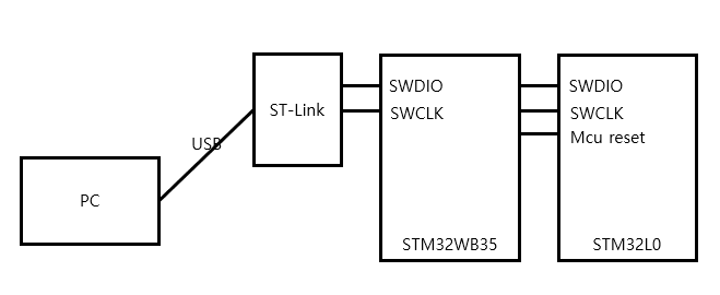

If the stm32 mcu is connected as shown in the figure below,
is there a way to download fw image from the master stm32(STM32WB35) mcu to the slave stm32(STM32L0) mcu?

Not with standard tools. You could implement the SWD protocol to transfer it from WB->L0 at great effort.
‎2021-01-14 5:57 AM
Well some of the L0 have a UART interface on the SWDIO/SWCLK pins.
Can probably done far more efficiently, with less code, using a very high speed serial connection.
From a debugger context you'd want to expose SWDIO/SWCLK from each processor to its own set of pins/pads
