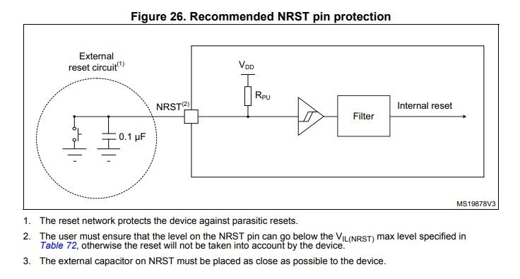

​I am surprised that the NRST pin is not having this kind of 3V3_STLINK pull up as on the picture below.
Could you check this?

Perhaps because you create different expectations in the Data Sheet for the parts? https://www.st.com/resource/en/datasheet/stm32wb55cc.pdf
You shouldn't need R or C parts externally, or any connectivity, for the part to start properly. Here you have a C to give some stickyness to the reset button, and the contact bounce.
The NRST usually gets clamped to ground when the POR circuit detects a brown out, or most often the absence of VDDA in STM32 designs.
‎2020-03-04 9:24 AM
The device has an internal pull-up on the pin, around 40K per docs. It is basically to ensure that the pin follows the supply ramping, and the pin is internally clamped to zero by the POR/BOR circuit.
Relying on RC time constants for reset circuits on synchronous designs is fraught with issues.

I didn't walk through the pin list, but nothing in the schematic was jumping out. The NRST shouldn't be driven HIGH externally, and should measure HIGH if the VDDA is present and it resets properly internally.
Soldering or circuit issues are one. Part orientation can be another, some ST parts have mold ejector marks that look like pin 1 designation. Not using the STM32WB part here.
