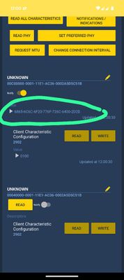

1. I have tried BLE Sensor example and send Hello World i got hex value of that, I am getting the String value...i have tried to get converted into string but failed.

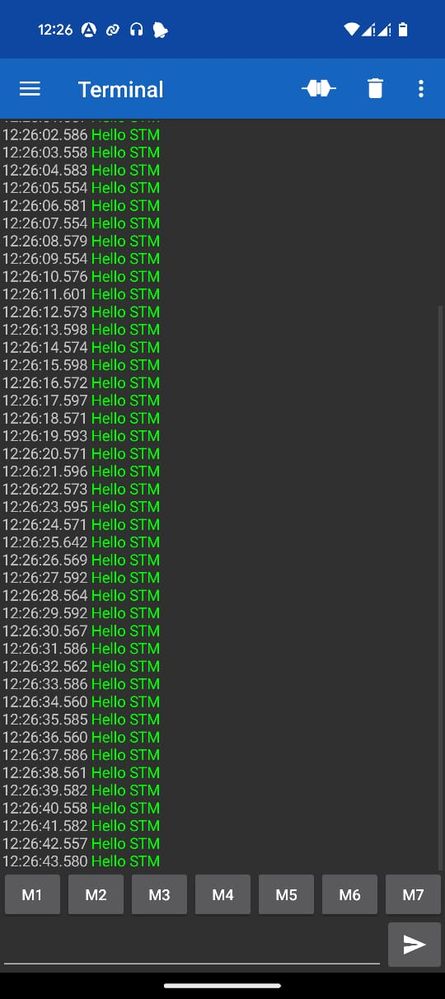

 2. I am sending data from other company microcontroller which supports BLE via ANdroid app Serail Bluetooth Terminal.
The same thing i want my STM32 dk should this.

Could you try your first solution with a mobile app that can do the conversation of the received data to a string.
Best Regards.
