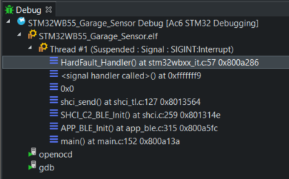

Hi Vyacheslav,
Thank you for your reply. I have tried the following code and it unfortunately results in a hardfault within APP_BLE_Init() that does not occur on 1st call on startup.
if(PWR->SR1 & PWR_SCR_CWUF4)
    LL_PWR_ClearFlag_WU(); // Clear WKUP Flags
    LL_C2_PWR_WakeUp_BLE();
    /* Delay 200ms */
    for(i = 0; i < 4800000; ++i);
    APP_BLE_Init();

On the other hand, if "shci_notify_asynch_evt()" is not called, then "APPE_SysUserEvtRx()" will not be called and "APP_BLE_Init()" too.
This means that the second stone is not working, but why, you need to find out.
