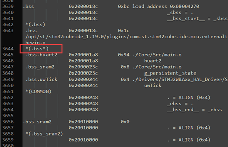

Your memory map is showing g_persistent_state is being placed on the stack. Make sure it is declared globally.
i changed it in the linker

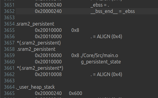

 SRAM2		(xrw)	: ORIGIN = 	0x20010000, 	LENGTH = 64K
      .sram2_persistent (NOLOAD) :
	  . = ALIGN(4);
	  KEEP(*(.sram2_persistent))
	  KEEP(*(.sram2_persistent*))
	  . = ALIGN(4);
	} > SRAM2
main.c
__attribute__((section(".sram2_persistent")))  volatile PersistentState_t g_persistent_state;
.map
The data was stored, Thank you
Why did it place what I configured earlier in SRAM1 instead of SRAM2, as I defined?
mbrossett
Glad it is working now. Your linker script has the bss section defined as *(.bss*). The wildcard right after the bss is what caused the .bss_sram2 to be placed in the bss section instead of SRAM2. Changing the name of the section fixed it. I didn't catch that after the first look of the map file and was thinking this section was defined as *(.bss.*) in the linker script which wouldn't have picked up your previously named section.
