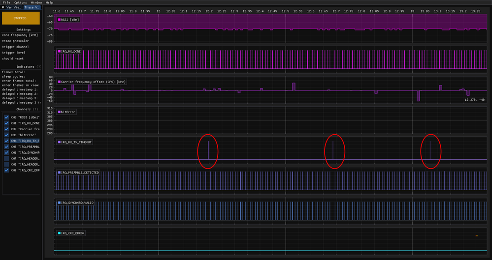

my setup consists of 2 NUCLEO-WL55JC1 boards and an adapted version of the example project SubGHz_Phy_Per with which I can recognize the number of bit errors, RSSI of the latest received packet and some interrupts (IRQ_RX_DONE, IRQ_PREAMBLE_DETECTED, ..) using Serial Wire Viewer and STMViewer.
Modulation is 2GFSK.
Tx-Node sends every 10 ms a packet with 80 bytes.
Overview of modulation and packet parameters:
  • RF_FREQUENCY: 868000000 /* Hz */
  • TX_OUTPUT_POWER: 14 /* dBm */
  • FSK_FDEV: 74680 /* Hz */
  • FSK_DATARATE: 149360 /* bps */
  • FSK_BANDWIDTH: 300000 /* Hz */
  • FSK_PREAMBLE_LENGTH: 12 /* Byte, Same for Tx and Rx */
  • FSK_FIX_LENGTH_PAYLOAD_ON: true
  • PAYLOAD_LEN: 80 /* Byte */
  • ModulationShaping: RADIO_FSK_MOD_SHAPING_G_BT_1
  • PreambleMinDetect: RADIO_FSK_PREAMBLE_DETECTOR_08_BITS
  • whiteSeed: 0x01FF; /*WhiteningSeed*/
  • SyncWord: { 0xC1, 0x94, 0xC1}
  • CrcLength: RADIO_FSK_CRC_2_BYTES_IBM
  • CrcPolynomial: 0x8005
  • CrcSeed: 0xFFFF
  • Whitening: RADIO_FSK_DC_FREEWHITENING
  • StopTimerOnPreambleDetect: 0
  • AddrComp: RADIO_FSK_ADDRESSCOMP_FILT_OFF
My calculations of Rx BW and Tx Fdev refer to Semtech SX1261/2  RF Transceiver Datasheet (p.43, LoRa Connect Transceiver, SX1261, +15dBm for Global Coverage | Semtech).
(2*Fdev + BR) < BW
I am aware that the bit error rate depends on the SNR. I don't understand why numerous packet losses occur, even over short distances (indoor) and acceptable RSSI, screenshot from STMviewer:
Packet Loss increases for much too small or large BW, which is understandable.
What possible mistakes have I made?
If you need further information, I can of course add it.

Hello @altoleoi
The packet losses depend on a few characteristics (modulation, TX_OUTPUT_POWER...). Also, it can depend on different external characteristics such as the electromagnetic interference, the Antenna gain, ...
I suggest you try to use a direct line of sight (LOS) between both boards and increase the TX_OUTPUT_POWER to the max value.
Best Regards.

Hello @STTwo-32,
thank you for your reply.
The board is delivered with an omnidirectional compressed whip / stubby antenna with a gain of 2dBi (should be ANT-SS900), which "[...] is stuck to the SMA connector because of FCC constraints". "[...] the FCC implies that the antenna must be stuck to the board connector with epoxy glue" (UM2592 - Rev 2, p. 27), therefore there is no possibility to change the antenna to increase the receiver gain.
Due to regional regulations, the ERP is limited to a maximum of 14dBm (13.98dBm).
Unfortunately, the required application does not guarantee LOS.
Best Regards
