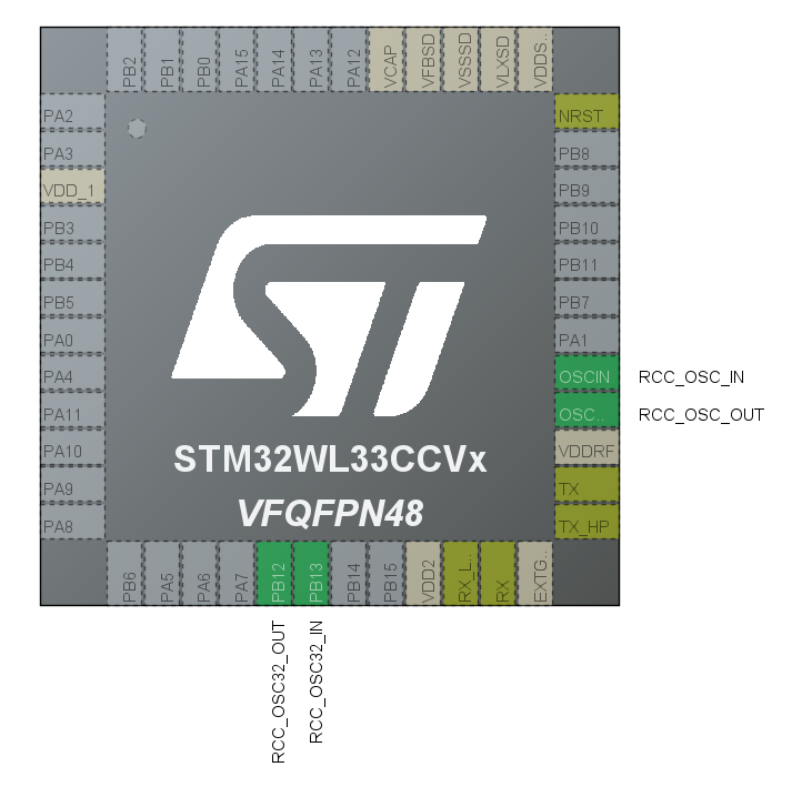

- created a new project in CubeMx selecting STM32WL33CCVx target

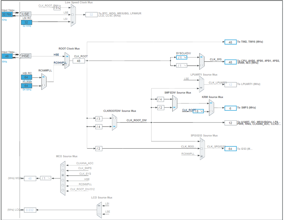

- enabled HSE oscillator and configured the clock tree in this way:
- thus we obtained this simple configuration:
