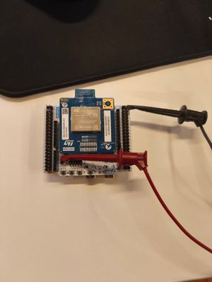

I am currently using STM32WBA65RI with Standby mode. According to datasheet, this mode should be able to reach 120nA current consumption with the 16 GPIO wake-up pins (RTC disabled). However running the Standby example and shutting down the RTC I am still getting 3uA of current consumption. What can I do to decrease the current consumption up to the nanoA?

I am using a Keysight B2901A for measurement. Connected directly to the MCU board.
The schematic is the one given by ST, I am not using any custom board.
It seems that, but actually it shouldn´t be waking up. I don´t think there is anything on the code that can do that.
I mean the schematic of how, exactly, you are connecting the SMU to the board.
I am connecting like this:
So you still have the mezzanine board attached!
My suggestion was that you remove the BLE board from the mezzanine - thus completely disconnecting everything, and ensuring that you are powering only the BLE part.

I have already tried that.. in that case I connect Vdd into PIN1 of CN4 and GND into PIN3 of CN4.
