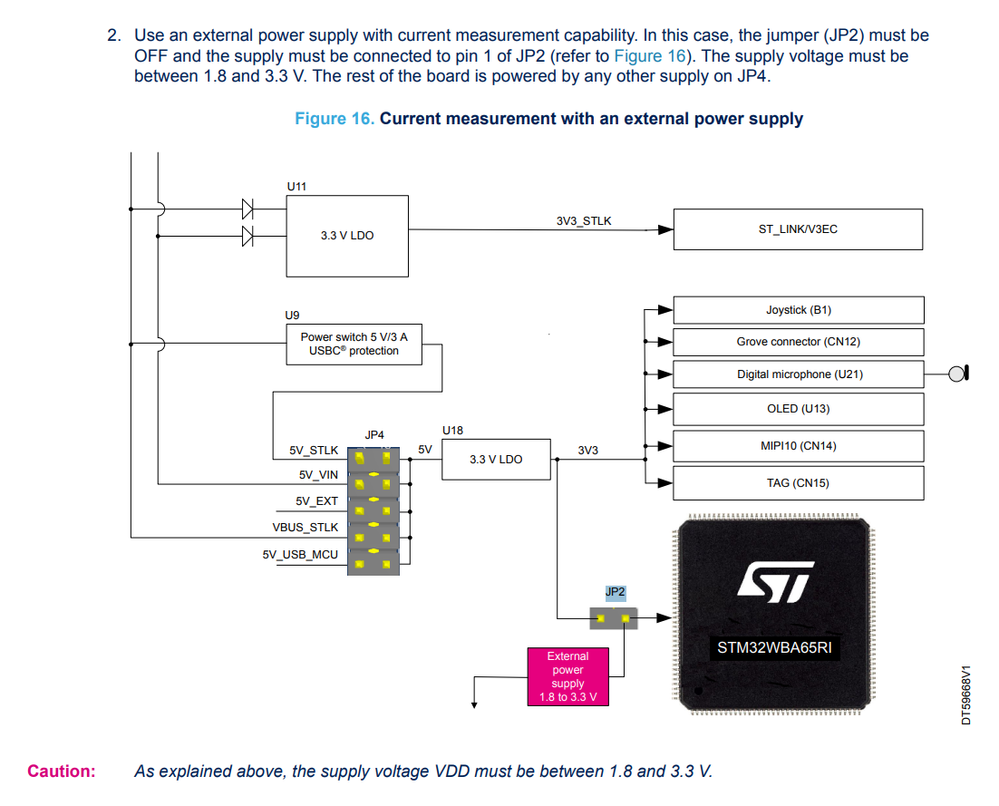

JPortilha
I am using the STM32WBA65RI Dev Kit. For current measurements, I am powering the board with an external supply that includes current measurement capability, connected directly to pin 1 of JP2. The JP4 jumper is removed.
According to the reference manual (Table 54), there are expected current consumption values for Standby mode (with RTC enabled and IWDG disabled).
I performed four tests with the following configurations:
  • RTC clocked by LSI and LSI/128
  • ULPMEN = 1
  • VDD = 1.8 V and 3.3 V
However, my measured current is consistently higher than the specified values:
  • LSI/128, 1.8 V → Expected: 210 nA, Measured: 658 nA
  • LSI/128, 3.3 V → Expected: 510 nA, Measured: 989 nA
  • LSI, 1.8 V → Expected: 330 nA, Measured: 835 nA
  • LSI, 3.3 V → Expected: 790 nA, Measured: 849 nA
My code is based on the ST example “Standby with RTC”, with the addition of enabling the ULPMEN bit in the PWR_CR1 register.

@JPortilha wrote:
I am using the STM32WBA65RI Dev Kit. .
Which one - NUCLEO-WBA65RI or STM32WBA65I-DK1 ?
You need to carefully check the schematics for all potential sources of leakage - in particular, connections to the ST-Link.
Your difference is on the order of only 400nA - it really doesn't take much leakage at all to make that !
I am using the NUCLEO-WBA65RI. According this this image, I am powering the MCU directly so the ST-Link below should be totally disconnected (I assume)
image.pngAlso, do you have any insights on how to integrate BLE advertise with this standby mode?

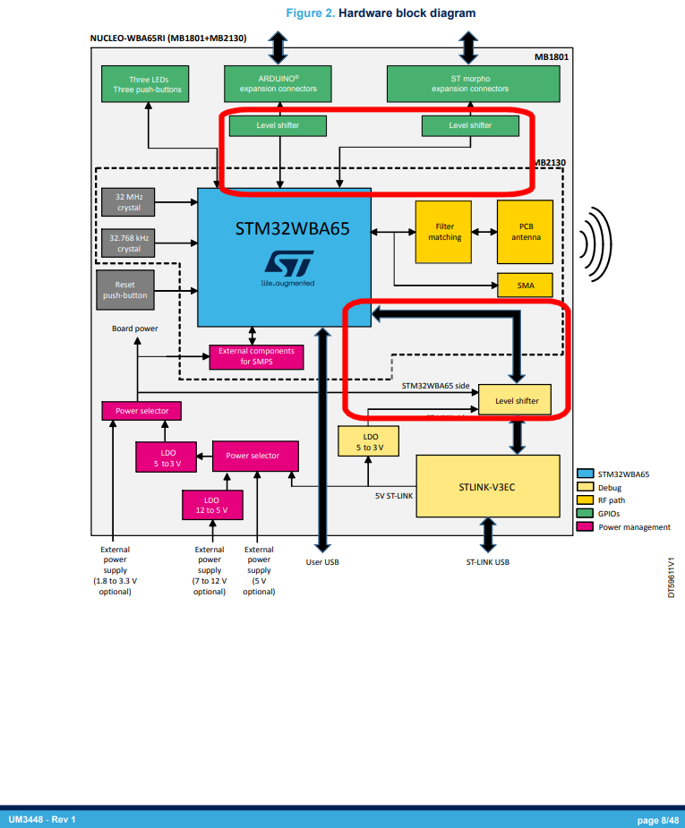

I think not: The ST-Link is still connected - just not powered.
Again, check the schematics to be sure.

What about all these connections (from the User Manual):
https://www.st.com/resource/en/user_manual/um3448-stm32wba-nucleo64-board-mb1801-and-mb2130-stmicroelectronics.pdf#page=8
Again, it's only tiny amounts of current you're talking about!
Maybe try removing the MCU RF board (MB2130) from the mezzanine board (MB1801) ?

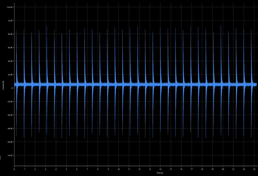

Hello, I have removed the MCU board (MB2130), and I am powering up via CN4 pins. I have shunted the necessary solder bridges underneath the board I got these results while in stanby mode.
image (1).pngI can´t figure out what are those negatives spikes. The average value should be around the nano amps scale, but again not the 330nA at 1.8V specified in the datasheet.
BR
I don't know.
What are you measuring with?
A schematic and some good, clear photos would help to fully describe the setup.
Is the chip waking up periodically - something just under 1s ?
What is the average current between the spikes?
Remember that the datasheet figure is purely internal to the chip, so you will never achieve that in practice:  there will always be some leakage due to external components - capacitors, etc...
