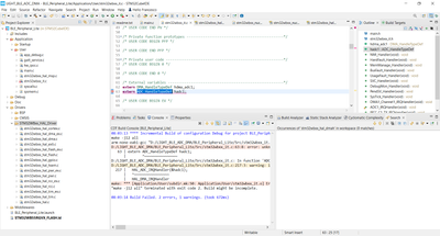

When I create my basic project   choose from ST32CUNE ide the example  ble_pheripal_lite all is ok .
The problems arrive when I want add  for example a new periperal how ADC ....
How can add in the driver the adc the stm32wbxx_hal_adc.c!!!!

First, you have to:
  • Add the "stm32wbxx_hal_adc.c" file to the Drivers>STM32WBxx_HAL_Driver of the project.

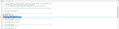

  • Add the line '#include "stm32wbxx_hal_adc.h"' on the 'stm32wbxx_it.c':STTwo32_0-1719224467971.png
