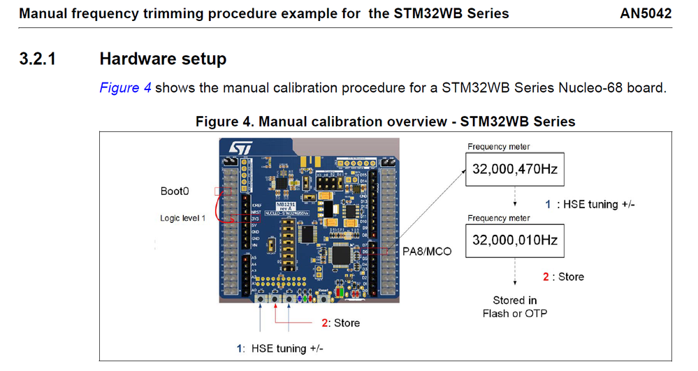

I am trying the manual configuration described in app note AN5042.

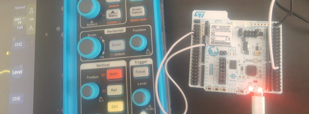

  1. I tie boot0 pin to 3v3v
  2. reset the mcu
  3. probe the D6 pin with an oscilloscope.... no signal

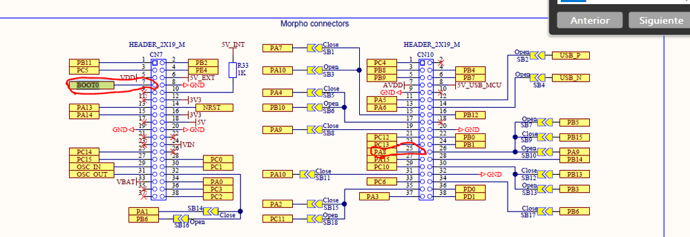

I checked the MB1355C schematics and pins should be ok
