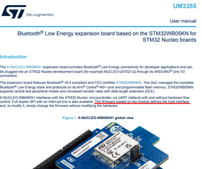

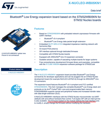

Andrew Neil is correct.  I'm looking for documentation for using the X-NucleoWB05KN1 board.  In the documentation is claims the UART binary is loaded by default, but NO DOCUMENTATION is included on how to interface with it.  What functions do you implement for RX/TX communications, what baud......
Indeed - in both the Data Brief and the User Manual:
Indeed not.
I can't even see anything which clearly states where the source code of this firmware can be downloaded - which makes the promise, "to modify it, simply (sic) change the firmware without modifying the hardware" meaningless!
Is it AT commands - or what ??
