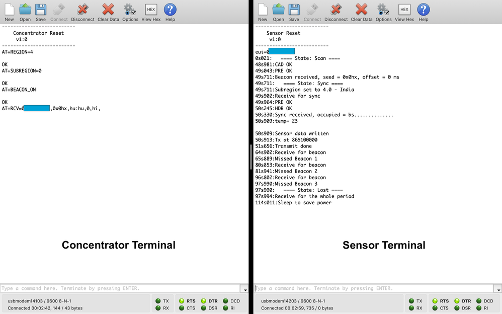

Hi, I tried the LocalNetwork demonstration in which one NUCLEO board acts as a concentrator and other NUCLEO boards act as sensor unit. Its available in STM32Cube_FW_WL_V1.0.0/Projects/NUCLEO-WL55JC/Demonstrations/LocalNetwork
I loaded and ran one NUCLEO board with LocalNetwork_Concentrator and one NUCLEO board with LocalNetwork_Sensor code. But my sensor NUCLEO board is not able to receive the beacon sent by the concentrator. I am not sure why this is happening. I have also attached the terminal image. Can you please guide why is the sensor not receiving the beacon?

Hi, I compiled the concentrator and sensor code using STM32CubeIDE version = 1.5.1
The issue I am facing with the board is, after giving the concentrator board AT+Beacon_ON command, the concentrator starts sending beacon and green LED starts blinking. Similarly on sensor board, LED 3 blinks rapidly with red color. As soon as the sensor board receives the beacon, the concentrator LED stops (i.e. it stops sending beacon). I guess the issue is with the concentrator somehow, I am not sure why does it stops sending beacon after finding a sensor node. I have tried to upload the concentrator code on two different boards, the same issue exists with both.
I tried it using a new NUCLEO board without compiling it with STM32CubeIDE, it works well with in this case, I have attached the image below. I am able to establish a connection between concentrator and sensor node in this case. Not sure why the issue is occurring after compiling the NUCLEO board with STM32CubeIDE.0693W000007DnenQAC.png

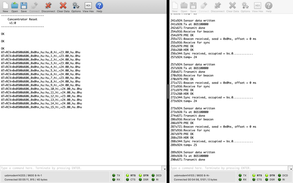

Thanks. I am able to connect the sensor now. But still one issue, in AT+RCV, the temperature data is correct, rest is not correct. Can you please tell why is this issue occurring?0693W000007DqK2QAK.png

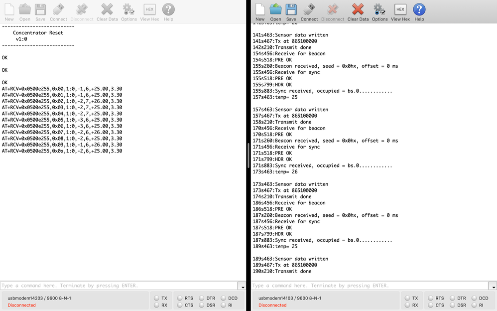

YBOUV.1
there seems to be an issue with the vsnprint and special formating with 'hh' or 'h' with gcc
They must be removed.
for example (in demo_report.c):
 APP_PPRINTF("AT+RCV=0x%08x,0x%02hhx,%hhu:%hhu,%hi,%hhi,",
      Header->eui, Header->packet_cnt, Header->version_major, Header->version_minor, Rssi, Snr);
should be replace by
 APP_PPRINTF("AT+RCV=0x%08x,0x%02x,%u:%u,%i,%i,",
sorry for the inconvenience
Let me know
JeffSm
Thanks for the help. It worked!
