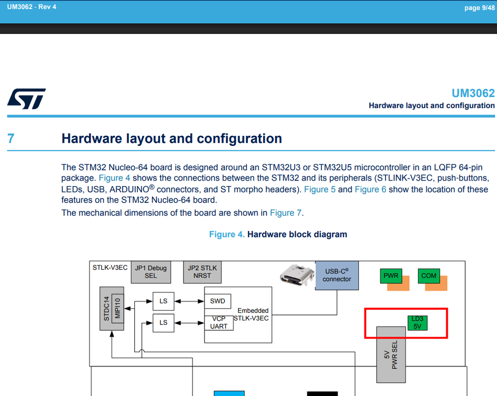

As @Mike_ST said, your Target has no power:
Hi Andrew
thanks for the post, is that my board can't be booted?
my LD3 flashes twices and then goes solid green
thanks
Of course - with no power, it cannot do anything !
LD3 shows that 5V power is reaching the ST-Link, via the CN1 USB connection:
But power is not reaching the target MCU - so, as @Mike_ST said, you need to check the board configuration.
