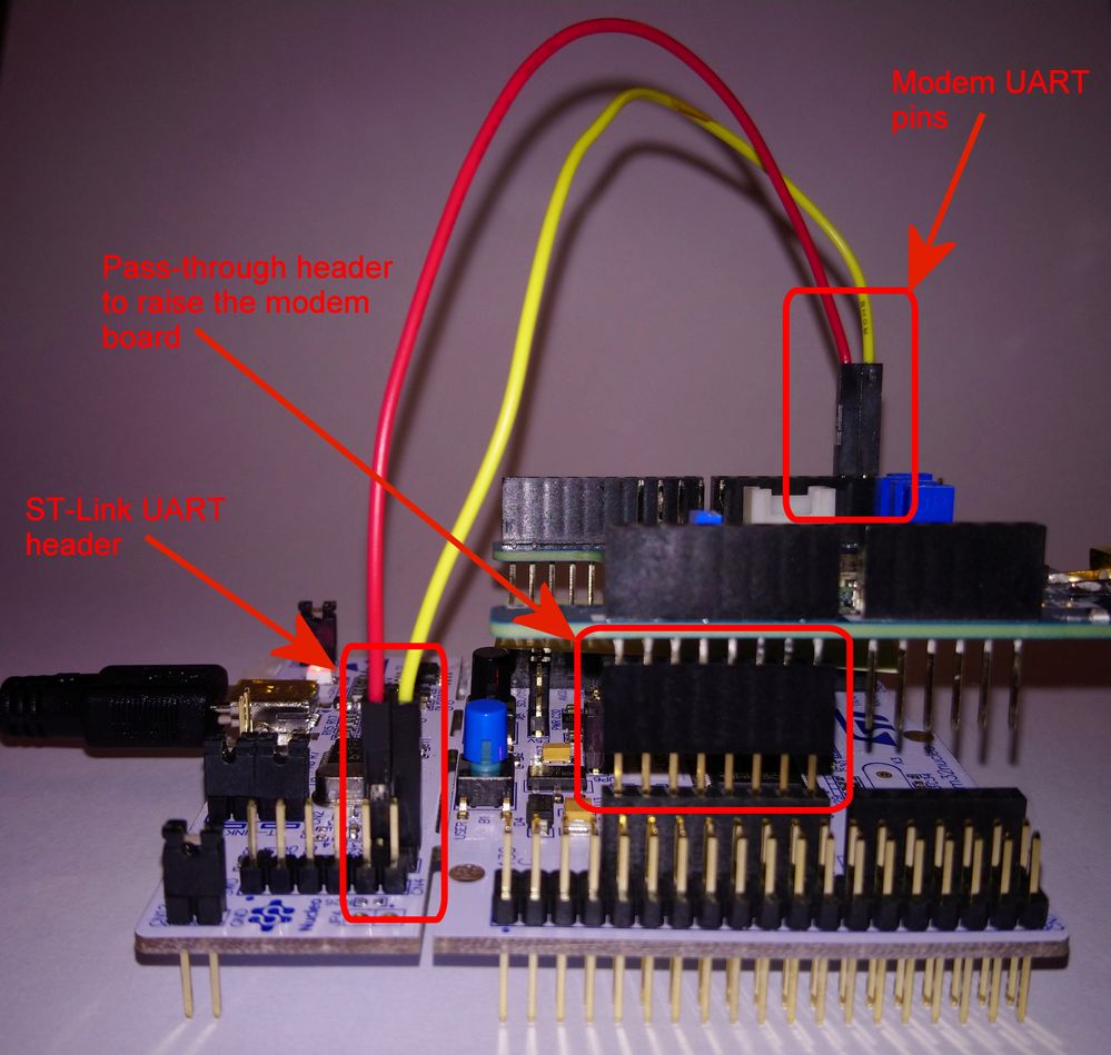

I just came across this.
The documentation does tell you that the ST-Link COM port is not connected through to the USI shield - so you obviously cannot send AT commands to it via the Nucleo board.
This does seem like a particularly poor decision.
To talk to the USI shield, you will need to disconnect it from the Nucleo board, supply 3.3V power, and connect to its UART pins.
I did it like this (I call the USI shield "modem"):

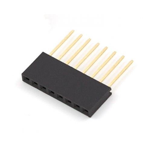

0693W000007BzUHQA0.jpgWith a "pass-through" header like this:
0693W000007BzVUQA0.jpgso that gives power to the USI shield ("modem") from the Nucleo board, but isolates everything else.
then the jumper wires connect the USI UART to the Nucleo's virtual COM port.
And then you can talk to the USI shield.
The NUCLEO-64 boards have a lot of annoyances/compromises, especially the sharing of pin/uart related to the VCP and ARDUINO header. The NUCLEO-144 solves these a lot better, you pay your money, you make your choices.

WOW! Your connections shown in your photo work! Thank You! Andrew! :thumbs_up:
ST should add this photo to the manual. A simple step saves many users` time.
