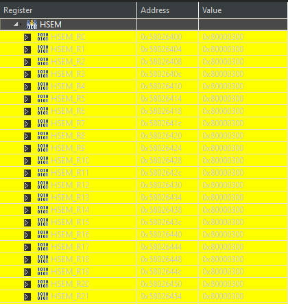

I'm playing around HSEM module and i noticed strange behavior. Why calling:
HAL_HSEM_FastTake(HSEM_ID_0);
or
HAL_HSEM_Take(HSEM_ID_0, 0);
lock all semaphores at once instead of just locking single semaphore specified by a macro using 0 as processid?
Then calling release will unlock only the one specified macro and we end up with 31 semaphores locked unintentionally.

Why do you think it's locking all 32 semaphores?
gasda.1

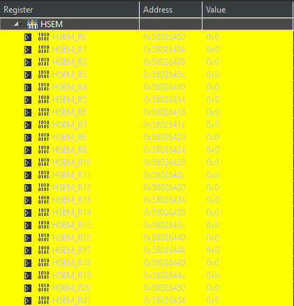

Because i've check it with debugger
This is state before calling HAL_HSEM_FastTake:
and this is after:
As you can see all semaphores has been locked by main cpu
Reading the RLR (read lock register), which you are doing by examining the value in peripheral mode, will lock the semaphore. Disable the RLR registers from being viewed.
gasda.1
Oh you are defenitely right, viewing in peripheral mode does lock every semaphore. Thanks for clarification!
