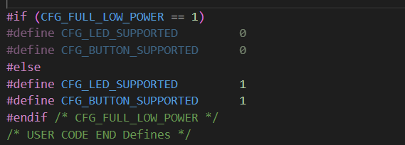

We are developing a Matter device using X-CUBE-MATTER.
When we set CFG_FULL_LOW_POWER to 1 to enable sleep mode, pressing B1 for 10 seconds does not enter Factory Reset and BLE advertising is not executed.
When we checked the current consumption, it seems to be in sleep mode, but because BLE advertising is not executed, commissioning is not possible.
Please tell me the solution or the specification.

in app_conf.h where you are setting CFG_FULL_LOW_POWER 1, there is also this code below.
2024-10-09 09_22_57-app_conf.h - STM32CubeExpansion_MATTER_V1.1.0 - Visual Studio Code.png
Which means that buttons are not used at all. You can simply change this define to enable them.

So, if the buttons are not available when CFG_FULL_LOW_POWER is enabled, how does Factory do it? Also, how is Advertising done?

As I said above you can change the above defines so that the buttons are active with low power. Then after rebuilding, you can use button1 to do factory reset and advertise.
With the default settings, factory reset cannot be done in low power mode.
