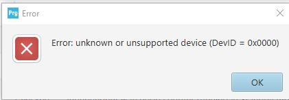

I assume that your board configured in USB DFU mode (with a jumper set on CN7 position (67 + the USB USER connector) is not discovered by CubeProgrammer because nSWBOOT0 = 0 while it should be set to 1 for the USB DFU mode.
--> I tried it now, but the error is after trying to connect:

Unfortunately it failed. same result with 2.8 version.
