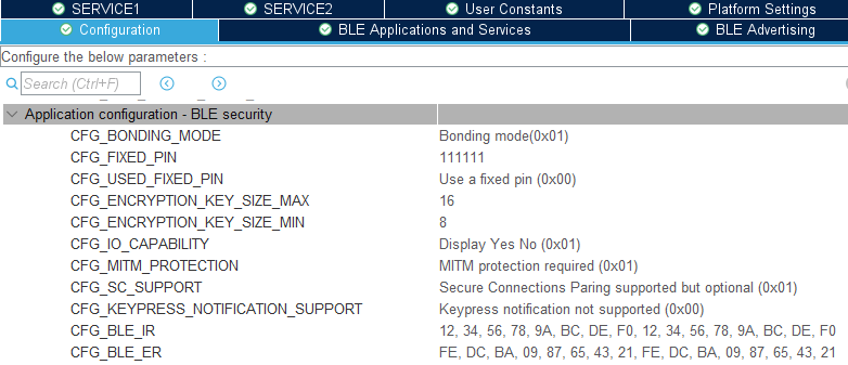

Is it really necessary to use TrustZone to encrypt BLE data?
What about the functions in the STM32_WPAN configuration with CubeMX such as
- Application configuration - BLE security?
Hi Ledi,
No, it all depends on the level of security you want and your application.
In that case, you can have a look at these 2 wiki pages which detail features such as: pairing, bonding, encryption, LE privacy etc...
STM32WB-WB0-WBA Bluetooth® LE Security - stm32mcu
STM32WB-WB0-WBA Bluetooth® LE Privacy - stm32mcu
