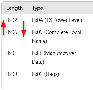

i use the example BLE_p2pServer_ota with STM32WBA55. When i scan the device, i get the advertising elements in this order:
I want to swap the first both elements. How and in which file can I change this order?

Hi Ledi,
you can manage ADV data in the app_ble.c
In BLE project by default, TX power Level is removed from the ADV data with the following code:
status = aci_gap_delete_ad_type(AD_TYPE_TX_POWER_LEVEL);
if (status != BLE_STATUS_SUCCESS)
 LOG_INFO_APP("==>> delete tx power level - fail, result: 0x%02X\n", status);
Then you can add it in the you want here:
/* Advertising Data */
uint8_t a_AdvData[26] =
 6, AD_TYPE_COMPLETE_LOCAL_NAME, 'H', 'R', '_', 'X', 'X', /* Complete name */
 2, AD_TYPE_TX_POWER_LEVEL, 0x??,
BR, Joé
