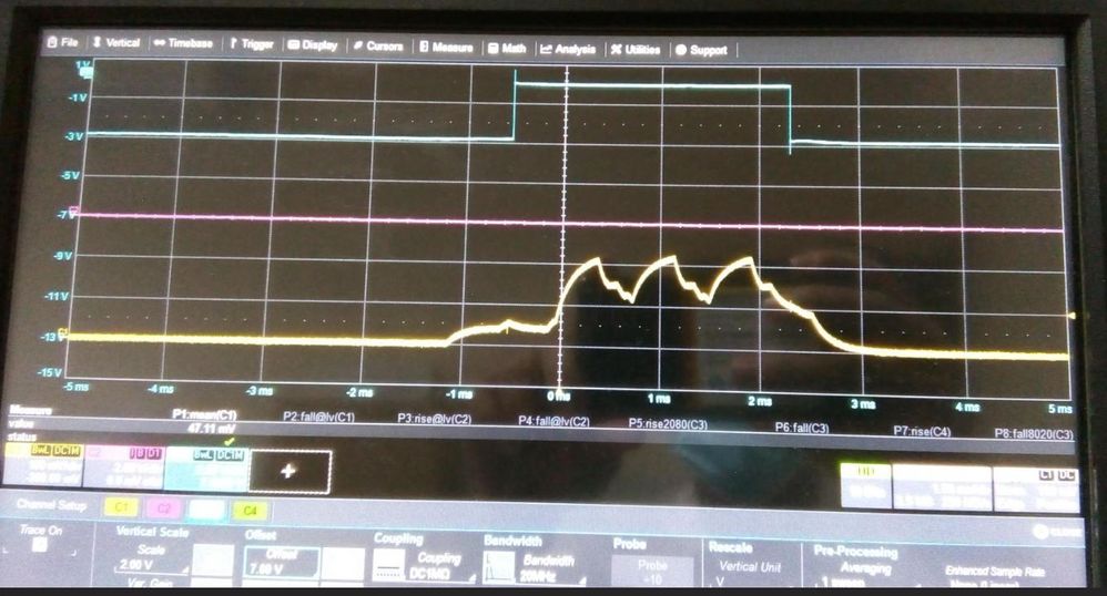

Hi Remy,
Thanks for the answer.
We implement the code following the application note.
The AN use PA0 for CSD, but we need to change it to PA1 because we use PA0 for other function already.
We were able to see the control signal for CSD as seen on below screen shot.
Unfortunately we still were not able to control PB0 pin for CTX.
I notice that this pin is dedicated for alternate function GPIO_AF6_RF_DTB0.
Is there any other thing need to be configured aside from the one stated in the AN?
Thank You
Remy ISSALYS
As describe in the AN, there is nothing to do besides GPIO initialization and send the command SHCI_C2_ExtpaConfig in order to inform the Cortex-M0+ firmware on which GPIO must be managed. The CTX and CSD signals are managed by the BLE stack, only GPIO initialization is done on M4 side.
