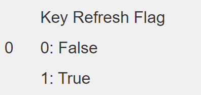

Hello EMECH,
Is there any updates for LPN node connection with two different and independent MESH networks?
I hope Key refresh flag changing in right way to allow new app key..
0693W00000QLGVLQA5.pngregards
