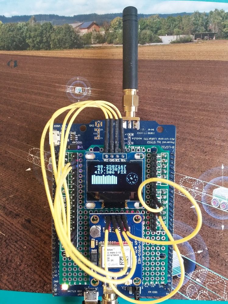

The models used for LRWAN and CubeMX are significantly divergent.
I added GPS and OLED display without using CubeMX
