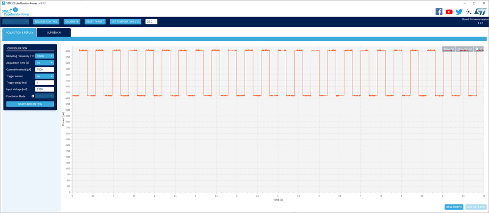

I'm in the progress of creating a peripheral BLE application using the STM32WB55CE on a custom board.
I'm trying to implement low power now, but struggling..

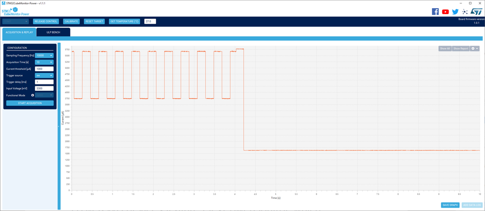

Using the X-Nucleo-LPM01A power monitor board I've measured my current consumption (no low power implemented):
0693W00000Lx43kQAB.pngThis is not impressive, but expected.
To get a grip on ST low power, I've run various examples on the P-Nucleo.WB55 dev. board, but it looks like the current consumption is very high no matter the example??? I've based my guesses on the Power features application note.

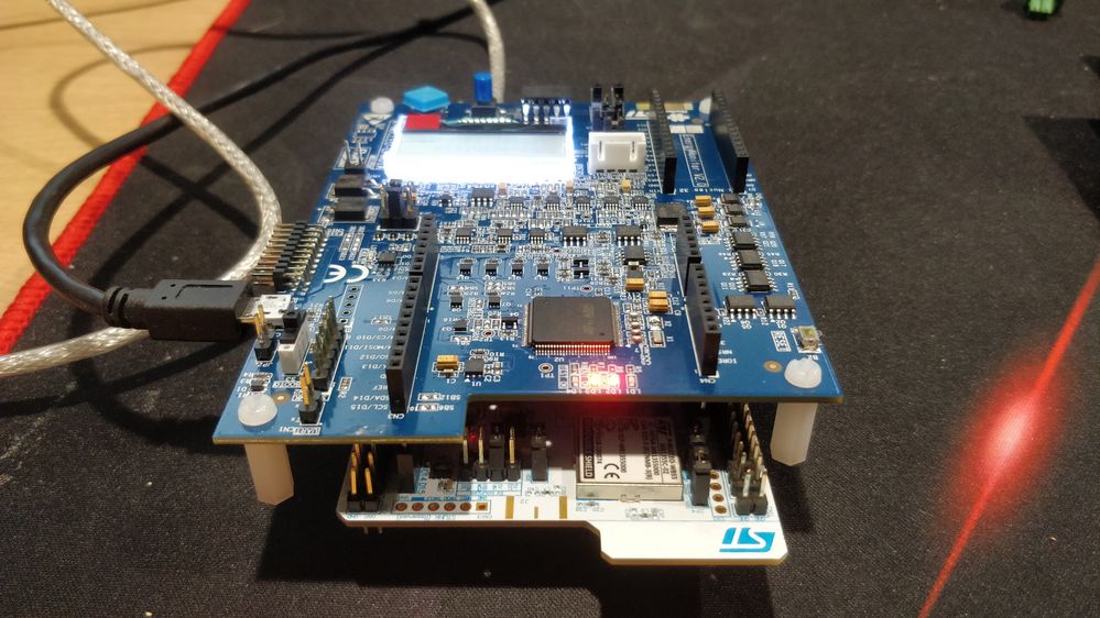

Setup:
0693W00000Lx3UzQAJ.jpgAll jumpers from STLINK is removed during test.

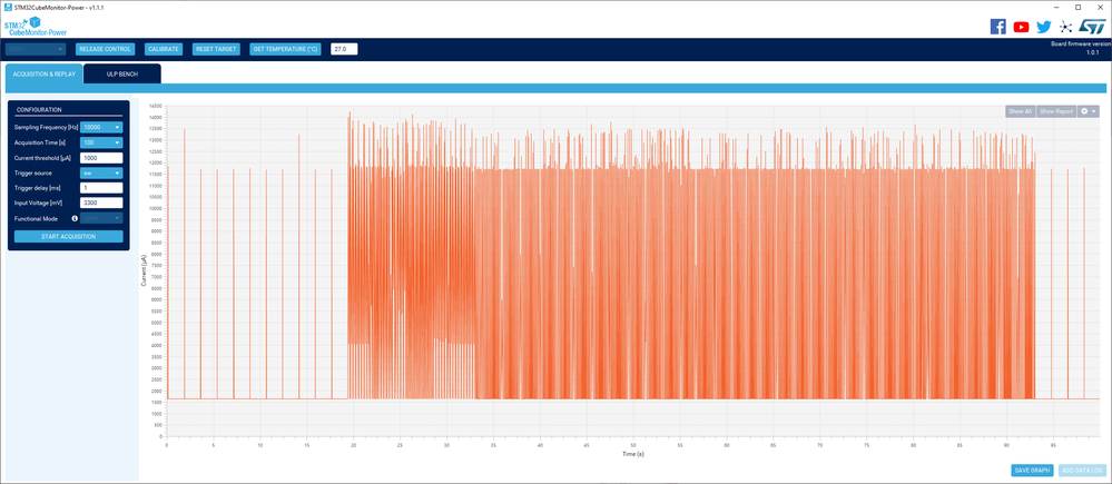

PWR_STOP2_RTC exampple:
0693W00000Lx3lRQAR.pngexpected ~2.2uA

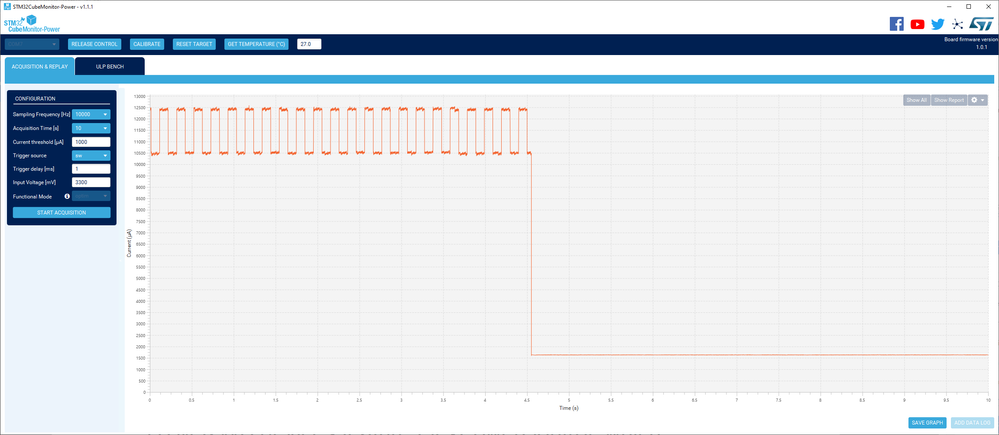

PWR_EnterStandbyMode:
0693W00000Lx3pAQAR.pngexpected < 1uA.

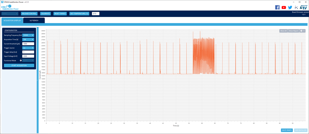

BLE_HeartRate:
0693W00000Lx3sIQAR.pngnot sure.

Using the X-Nucleo-LPM01A power monitor board to do consumption measurement, it's a good strategy. To avoid overconsumption, try to supply the P-Nucleo.WB55 only with 2 wires from X-Nucleo-LPM01A :
> The first one from AREF pin of X-Nucleo-LPM01A to VDD pin of JP2 P-Nucleo.WB55 (remove the jumper)
> The second between GND pin of X-Nucleo-LPM01A and GND pin of P-Nucleo.WB55
In addition, remove all jumpers on JP5 and don't power the P-Nucleo.WB55 with USB cable.
Use BLE_HeartRate example which allows to do STOP2 low power mode.

How is real measurement?
I'm not 100% on what is defined by "real" meassurement...
BUT, I've used a Branford MBGI020083 to measure the current over JP2.
PWR_SMPS_16MHZ_HSI with RF Stack:
3-5mA
PWR_STOP2_RTC:
~3,8uA i think...
~1.3uA
BLE_HeartRate:
~200-220uA (no connection)
~3-130uA (no connection after some time - I reckon LP advertising kicks in?)
~1100uA (connected)
I'm Quite confused now, but this must mean that low power works, but measuring with the X-Nucleo-LPM01A is a bad strategy?
