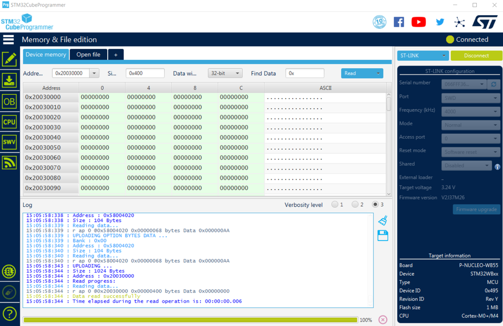

If I read the same address using the STM32 Programmer GUI, at first I get the same thing:

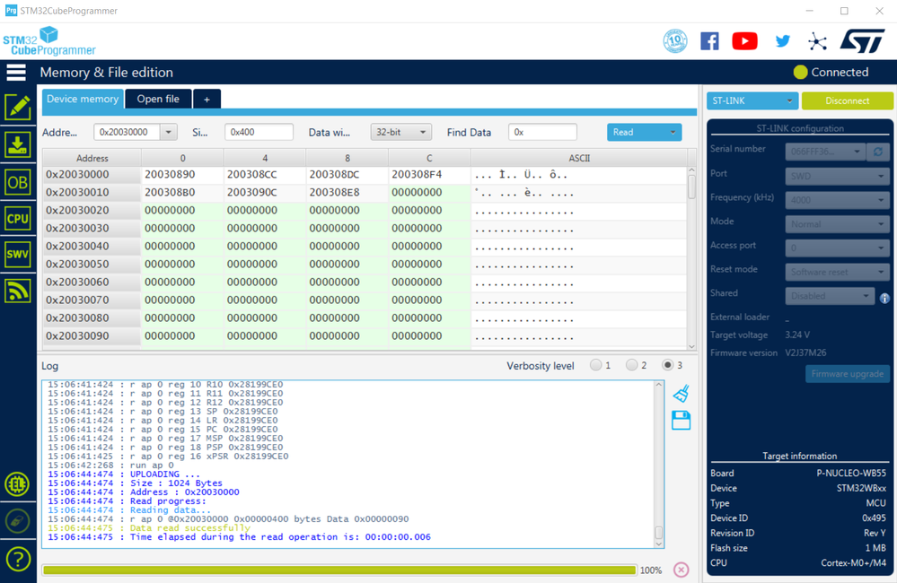

0693W000008GUVXQA4.pngHowever, if I switch to the CPU tab in the GUI and hit 'Run' first, I can check address 0x20030000 and I find a value of 20030890:

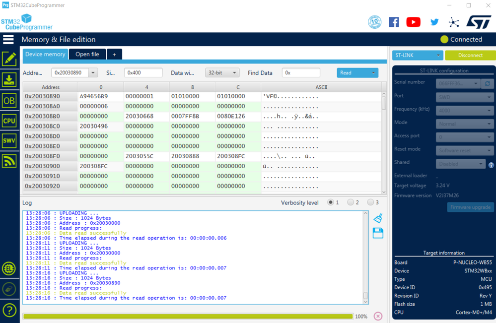

Then, I can read address 0x20030890, and I find the device info table, including the 'table valid' bytes 0xA94656B9:
Success! It seems that hitting the Run button makes all the difference for the GUI.
