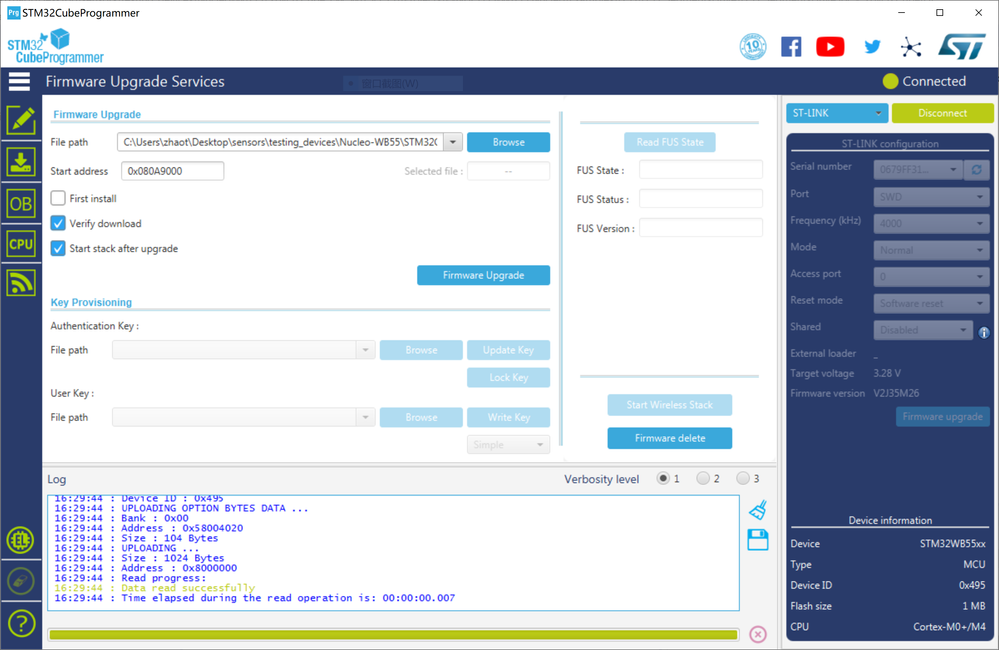

I am trying the zigbee apps in 'STM32Cube_FW_WB_V1.7.0'. However the firmware upgrade is never successful. I followed the Release Note but i can't get FUS state. I have tried with FUS 1.02 and 1.1 but it doesn't work. I thought maybe FUS is already up to date, so I tried zigbee firmware. It doesn't work, although I believe that I entered correctly the address in the binary table. I can still connect the nucleo board via stlink, but my PC no longer recognizes the USB dongle. The log is shown below, do you have any idea what is the problem?0693W000001stXgQAI.png

There are many separate issues there.
When using the SWD interface, be sure to set the nSWboot0 to 1 before switching the USB interface in DFU mode.
Then set the reset mode to hardware mode.
Note that is not possible to read the FUS version via the SWD port. This isthe reason why this feature in not available with the GUI interface.
the FUS_STATE_IMG_NOT_AUTHENTIC error message may result from a previous FW installation. Be sure to perform a partial mass erase of the user part of the flash memory to ensure a clean memory before any programming.
Ler me know if all these remarks were helpful.
