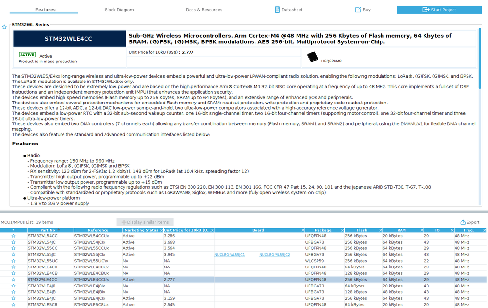

Thanks for your response. Honestly, I was a bit confused about the STM32WLx4 line because the header-description does not include LoRa but the "Features" says it does! (picture attached). Should I understand it as a mistake in the description below?

​It is not a mistake. It may have been written in a way to lighten the introduction.
But in fact Lora modulation is only available for the STM32WLx5 line.
Remi QUINTIN
​The feature list apply to both STM32WLx5 /x4 lines.
Anders Dam Kofoed
Sorry, but I do not understand your answer.
Reffering to the screenshot above, for the STM32WLE4CC, underneath the section "Features" is a section "Radio" in which the second line "Modulation" contains the word LoRA.
So does the STM32WLE4CC contain a LoRa radio or does it not contain a LoRa radio?
If it does, then the spec-sheet is mistaken (and vice versa).

Remi QUINTIN
The STM32WLE4CC device does not support LoRa modulation.
