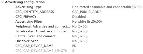

- P2P Server is operational and available on the ST BLE Toolbox phone app.
- P2P Server advertising settings as below

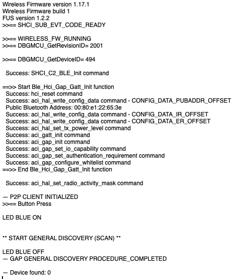

- P2P Client is running and a button press will initiate a scan as below.

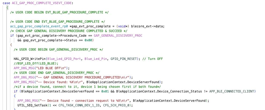

In app_ble.c of the p2p_client the advertising data is filtered for manufacturer specific data. I added the the print messages below to see what k+2 and k+3 was.
To proceed to connect k+2 must be 0x01 and k+3 0x83.
I also had to reduce the adlength filter to 4 instead of 7.

if (adlength >= 4 && adv_report_data[k + 2] == 0x01) //>=7 in example
{ /* ST VERSION ID 01 */
APP_DBG_MSG("--- ST MANUFACTURER ID --- \n\r");
switch (adv_report_data[k + 3])
{ /* Demo ID */
case CFG_DEV_ID_P2P_SERVER1: /* End Device 1 */
APP_DBG_MSG("-- SERVER DETECTED -- VIA MAN ID\n\r");
Print result:
Manufacturer Specific Data
k+2: 1
k+3: 83
Ad Length 4
— ST MANUFACTURER ID —
— SERVER DETECTED — VIA MAN ID
Event Type: 00, Data Size: 19
Advertising Data: 02 0A 00 03 09 50 44 03 03 0D 18 04 FF 01 83 00 02 01 06
To change the manufacturer specific data use either:
app_ble.c in p2p_server app and update the a_AdvData array:
4, AD_TYPE_MANUFACTURER_SPECIFIC_DATA, 0x01, 0x83, 0x00 /* */,
Or, use CubeMX to update this same line of code here in your p2p_Server.ioc:
