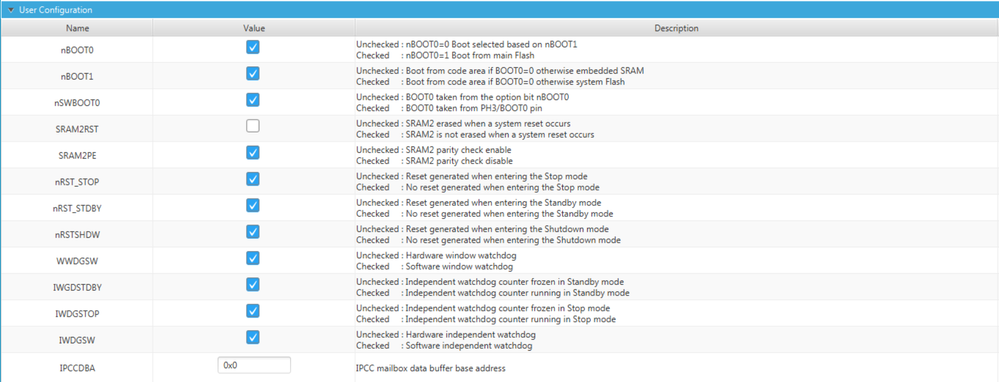

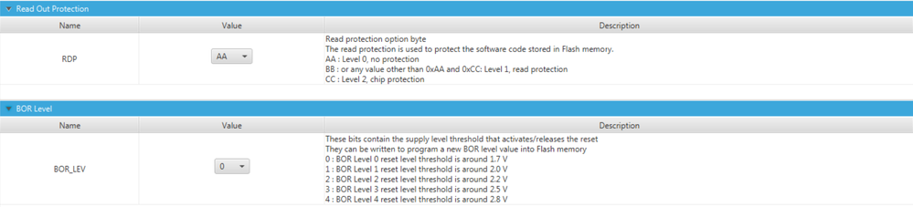

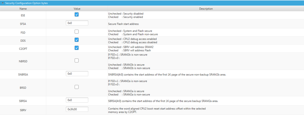

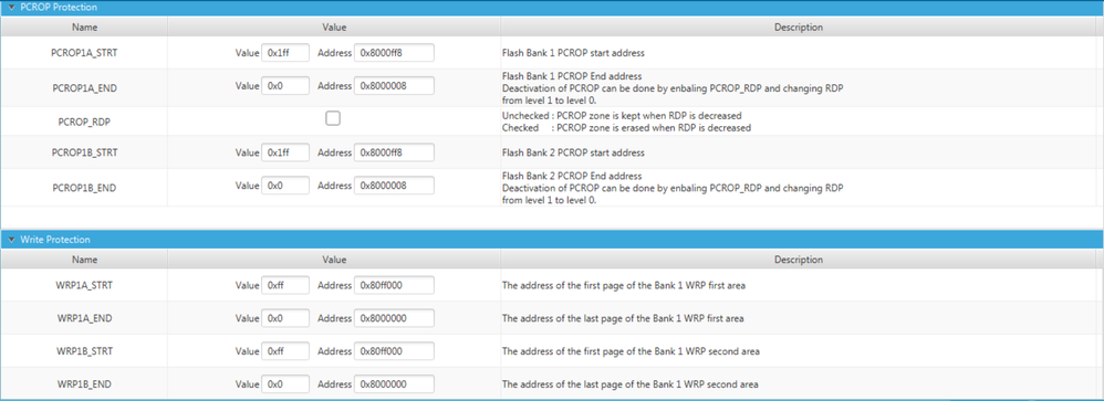

abbas14
March 13, 2020
Thank you, @Andrea Nisticò​, for suggesting that solution.
Tried that, and my controller is now permanently read-protected! I am unable to revert it to its normal functionality.
Please find attached screenshots of the current status of the option bytes.
It would be really appreciable if anyone could guide me to the current state of my device, and whether it is recoverable.

Remi QUINTIN
March 13, 2020
I Just saw that the SFSA pointer is set to 0. This is not a good news.
Did you never manage to upgrade the FUS on this Nucleo board?
Which port did you use?
Were you able to load FUS v1.1.0, I would be able to recover from this situation.
Now there is nothing obvious to do.
abbas14
March 16, 2020
Nope, I was never able to upgrade this device!
I just set the read protection byte to 0xBB (from the default 0xAA), and it's stuck since then.
This device is on a custom board, and is being programmed through ST-Link.

Remi QUINTIN
March 18, 2020
So the FUS had indeed been upgraded. Unfortunately, this is not enough to get your board back to work as the SFSA pointer = 0.
This is a quite weird situation as this sequence should not failed , leading to this blocked board.
