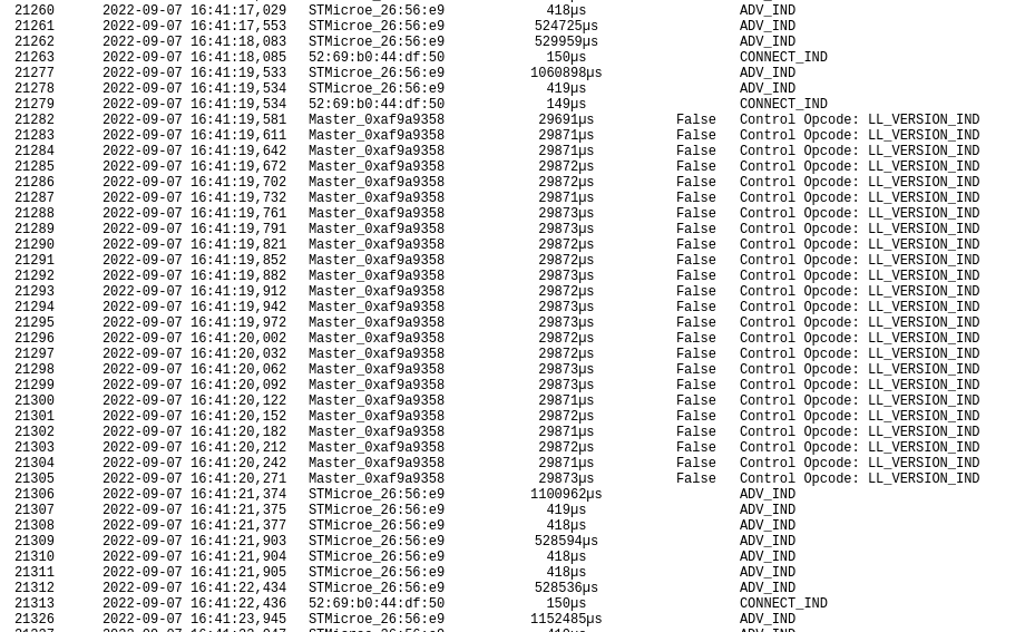

My custom device with custom firmware don't respond to LL_FEATURE_REQ so the device disconnect.
The connectivity part of my project is very similar to the example BLE_p2p_server, the device start advertising and when I connect to it with the mobile app ST BLE TOOLBOX the connection fail, in wireshark I see the master device is sending LL_FEATURE_REQ but the device doesn't respond.

I share with you the wireshark logs (remove the .csv extension)

I attached the wireshark logs, remove the extension ".txt" added to be abble to upload the file.
In this test I tried multiple times the connection, as you can see the app logs below, the first 5 tries failed with reason 8 then switched to reason 0x3E, After the 3 first tests I reset the device.
I used for this test the Xiaomi phone.

HSAADI
And rarely the device send the response of LL_FEATURE_REQ, I attach wireshark logs
HSAADI
I attach also the logs of the first time that LL_FEATURE_REQ succeeded (remove the .txt extension)
thanks.

HSAADI
Resolved by setting CFG_BLE_LSE_SOURCE to 1 in app_conf.h
