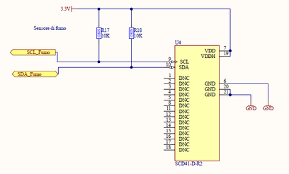

Good evening, I ask for help regarding the communication between stm32wb5mmght6tr and the scd41-d-r2 sensor.
I connected the sensor to pins PC0 (SCL) and PC1 (SDA) and powered the sensor but after loading the code I attach, the i2c communication gives me an error (they don't communicate). I checked the address of the sensor and it is correct and also the connections. Anyone know what it could be? Thank you in advance.
circuito di connessione del sensorecircuito di connessione del sensore
