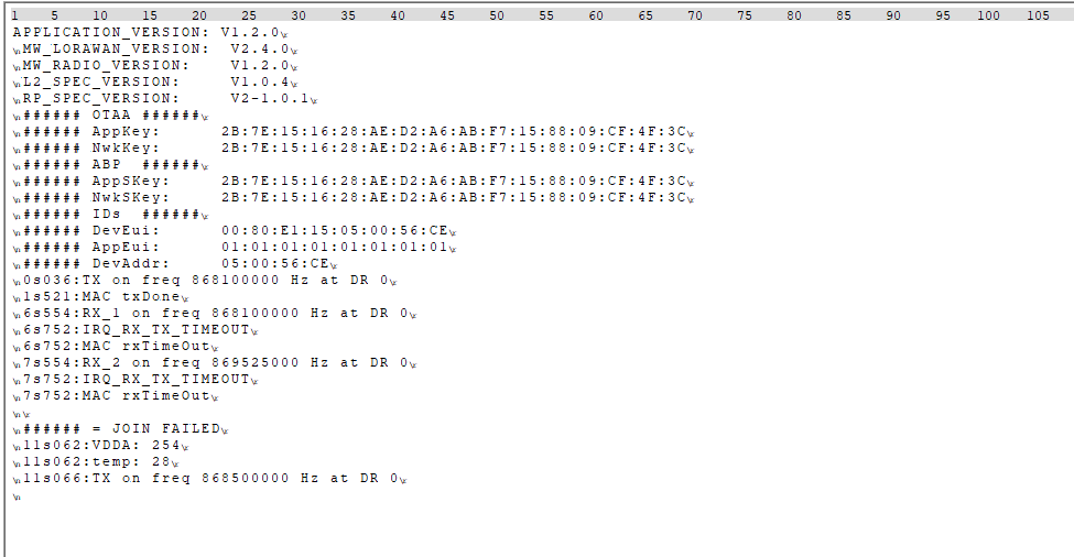

The problem: as in the code, I set the sensor to work in sequential mode, however, the whole setup stopped working after the first measurement. The same thing happened when I set the sensor to work in parallel mode. Sleep mode worked okay and for Forced mode, I could achieve the first measurement before the sensor turned to sleep mode (correct).
Question: Where should I start tracking the problem or how do I fix this problem?

‎2022-09-08 9:15 AM
Thank you for your clarification. Right now instead of adding the sensor reading in the middle of SendTxData(). I declared a sensor reading as a function and register it as a task. That task has the same priority as the SendTxData():
UTIL_SEQ_RegTask((1 << CFG_SEQ_Task_LoRaSendOnTxTimerOrButtonEvent), UTIL_SEQ_RFU, RetrieveBMEData);
I also did as you suggested: I declared 4 private variables in the lora_app.c namely sensorTemp, sensorHumd, sensorPress, and sensorGas. These variables are updated when the sensor reading function run.
However, the program still stopped working.
Should I continue with this solution (making the sensor reading as a task) but change the priority of the newly declared function? In that case, what should be the priority of this function?
