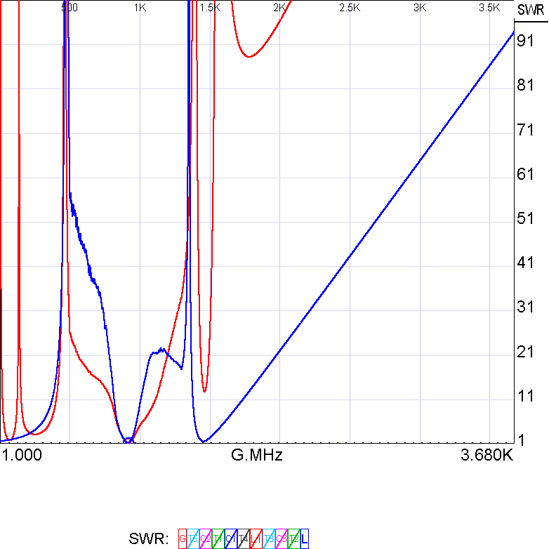

I want to use the Johanson 0915AT43A0026 chip antenna. In the datasheet they state that a pi-type L-L-C network (4.7nH, 10nH, 0.5pF) is required for this chip with a 50Ω feed.

You can use it. There is no problem. The RF switch should see 50 Ω from your L-L-C network and your antenna chip should see its impedance conjugated.
Note that the 50 Ω feed comes from the RF SW output (when using RFO_LP or HP).
FYI: when using the RFO_HP, due to the RF power, the Pi-structure before the antenna should be used also as a low-pass filter.
Some amount of harmonic energy will pass the RF SW and reach the antenna.
In your case, your L-L-C network will acts as a LP filter.
I suggest you to simulate (AC analysis up-to 10 GHz, e.g. with LTspice) this network with the impedance of your antenna and see the attenuation inserted by this structure for the harmonic frequencies (2f0, 3f0, 4f0 etc).

I eventually found an S-parameter file from Johanson for the chip plus matching circuit.
I have tuned the matching circuit from the RF design guide using SimSmith and the S-parameter file as the load.
The S-parameter file doesn't reach up to harmonics of 920MHz but normal sweep does include the file data points when the range is larger.
The first image is a sweep up to 4th harmonic, blue is the S-parameter file (load) and red is with my matching circuit. You can see the discontinuity in the blue line at around 1.3GHz where the S-parameter file ends.

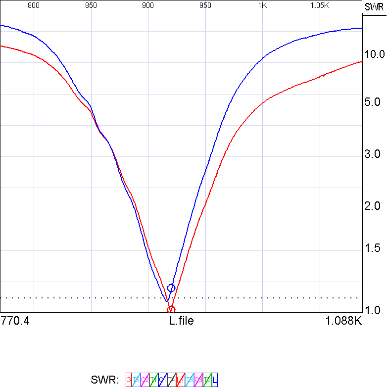

0693W000008vywaQAA.pngThe second image shows the improvement of the matching at 920MHz. The SWR does lower a bit on the higher side of 920Mhz but it should be okay.
Does this seem reasonable to you?

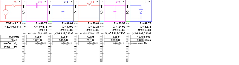

I found it at their product page for the 0915AT43A0026 which was surprisingly hard to come across.
My main concern is that they don't specify which matching circuit is being used as there is more than one on the datasheet, so I went with the main one (4.7nH, 10nH, 0.5pF) which was also present on older versions of the datasheet.
My 920MHz circuit is the following, with very short transmission lines matching the traces on my PCB layout.

If your concern is just about the circuit topology, make sure that you have the right PCB antenna designed on your PCB.
Note that the designs are not the same.
For their "Mounting Considerations II", the beginning of the antenna is shorted (connected to "GND plane").
If you have drawn the antenna that we see in the "Mounting Considerations I" (page 2 of the datasheet), so you need to use the C-L-C matching circuit (4.7nH-10n-0.5pF).
Note also that the values of these components are not correct for your operating frequency that is 920 MHz.
I think that you will need to re-tune those values in order to get an acceptable S11 at 920 MHz (S11<=-15).
If these components are routed very close to each other, the transmission line will have a little impact (~2°; ~4°) and their values will change mainly due to the frequency (915 vs 920).
I suggest you to use the spice models of the L-C-L components to make some more realistic simulations (the best approach is to use Keysight ADS, but you will need a license).
I took the spice models for (4.7nH-10n-0.5pF) provided muRata and I simulated it with LTspice XVII (but in S-parameter's domain).
See the file attached.
You need to include the .asy files in "C:\Documents\YOUR_USER\LTspiceXVII\lib\sym" and run "SParams_Johanson_0915AT43A0026.asc" with LTspice.
