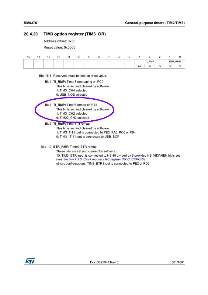

I have generated the code for PWM generation using STM32 CubeMX and it is working fine on B-l072Z-lrwan1.
But when I was trying to integrate same code with the existing Ping Pong example, I was not getting any PWM signal on respective pin. I have also configure the pin according to timer and channel with the help of datasheet and also check the alternate function for the pin.
I have tried different Timers but I am not getting any PWM signal at output.
Can anyone tell me, why this is happening?
13 REPLIES 13
waclawek.jan
Okay, so read out and check/post also this register:0690X00000ARDbkQAH.jpg
Thanks for your help.
cpc
Now I am getting the PWM. But the problem is SPI clock is affecting the PWM.
PWM is resetting according to SPI and when I disabled the SPI I am getting exact PWM as required.
According to me SPI clock is triggering the PWM.
What can be done to avoid this ?
